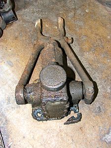

While "off-roading" through a pasture (at the first checkpoint I might add), we hit some very rough ground, bottoming out several times. When we got back to a "real road" we noticed that the front left had changed both camber and toe-out. Other than an inspection (which we obviously did not do very well) we "pressed on regardless" and finished the rallye (in second place). That was at least 600 miles of hard running....after the damage had occured. There was not significant shimmy in the wheel: the car tracked fairly straight; the tire did not show any odd wear at the end of the rallye.
I talked with John Mangles this morning; he offered to open his shop to take a closer look at what may have happened. (What a guy! He had a used shock installed and we were on our way home in about an hour)
We were VERY lucky that we didn't have a catastrophic failure: the front two shock bolts were missing and the shock(s) of bottoming out had broken one of the rear mounting "ears" on the shock. Had we broken the other ear, I don't want to think what could have happened.
I'm not sure when the last time that either of us had checked the torque on these bolts...but you can be sure that it will be a regular maintenance item in the future.
