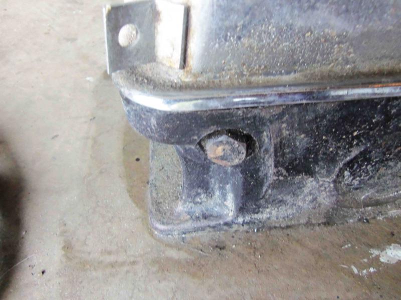

What is that bolt for? On the TR250 and TR6 it is used for additional lubrication for the rocker shaft. Particularly for racing. Is it for the same thing and has anyone hooked it up. Any unintentional consequences?

I'm not sure, could be oil, but most likely water. Remember the head only gets metered oil from the back of the cam...so very little pressure if it is oil.
Its a blanking plug, where the oil passage is drilled sideways. Moss and others sell the kit to feed high pressure oil through it.
I tried it (on an engine where the normal passage was blocked) and didn't like the results. Way too much oil up top!
The experiment ended when one of the valve seals I added came apart, and the excess oil being sucked into one cylinder at freeway speeds caused a broken pistonIts a blanking plug, where the oil passage is drilled sideways. Moss and others sell the kit to feed high pressure oil through it.

I heard the same thing on the 6 cylinders too. The rockers only get momentary oil pressure from the rear cam bearing where there is a flat spot and when it comes around it sends oil to the rocker shaft. What if you reduced the size of the hole in the bolt for the banjo fitting therefore reducing the amount of oil to the top of the head. Should cut down on flooding the valve guides with too much oil and you should have 100% pressure to the rockers.
I tried several things like that but not making a new bolt. I'll let you try that one!
