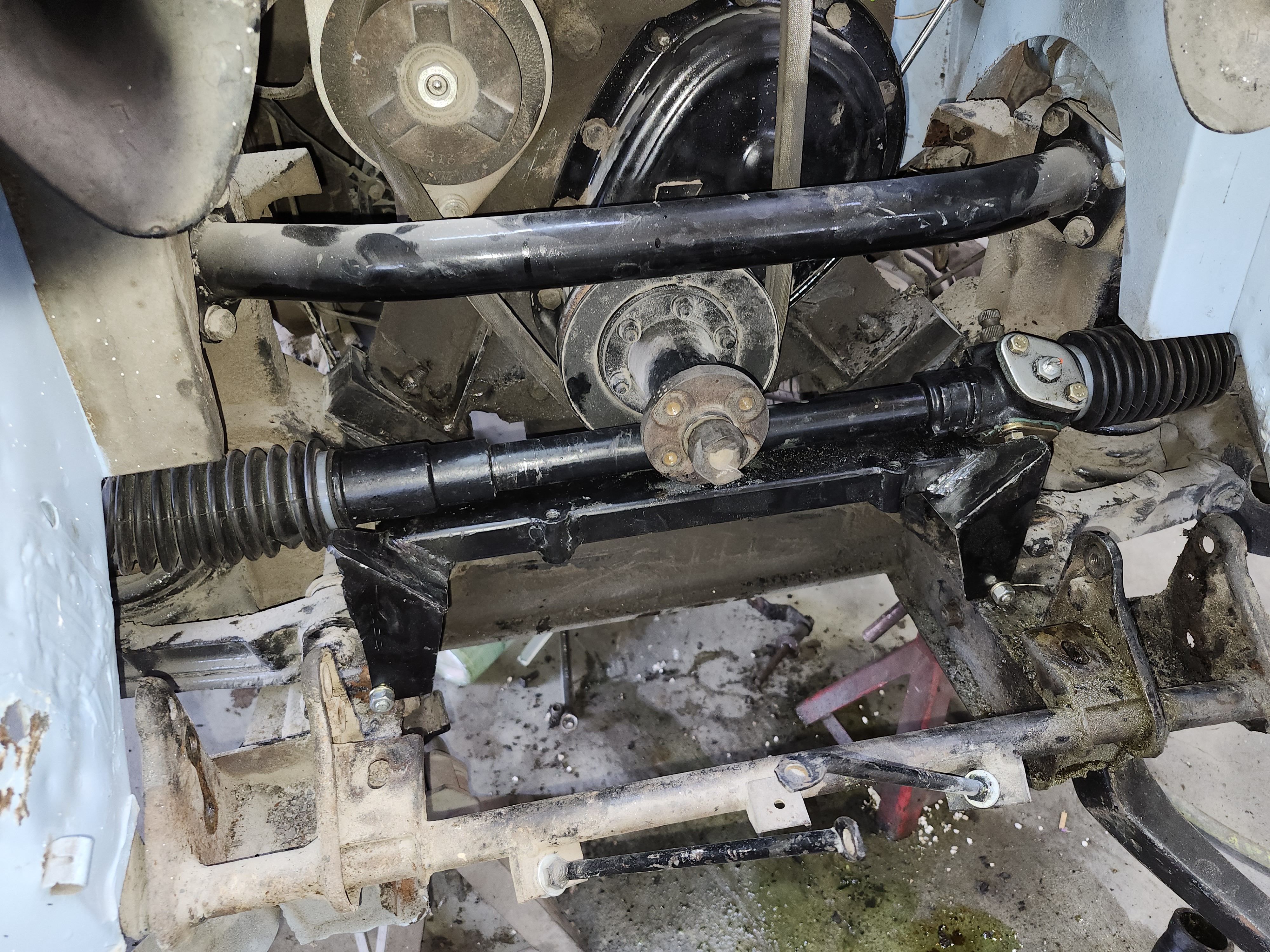

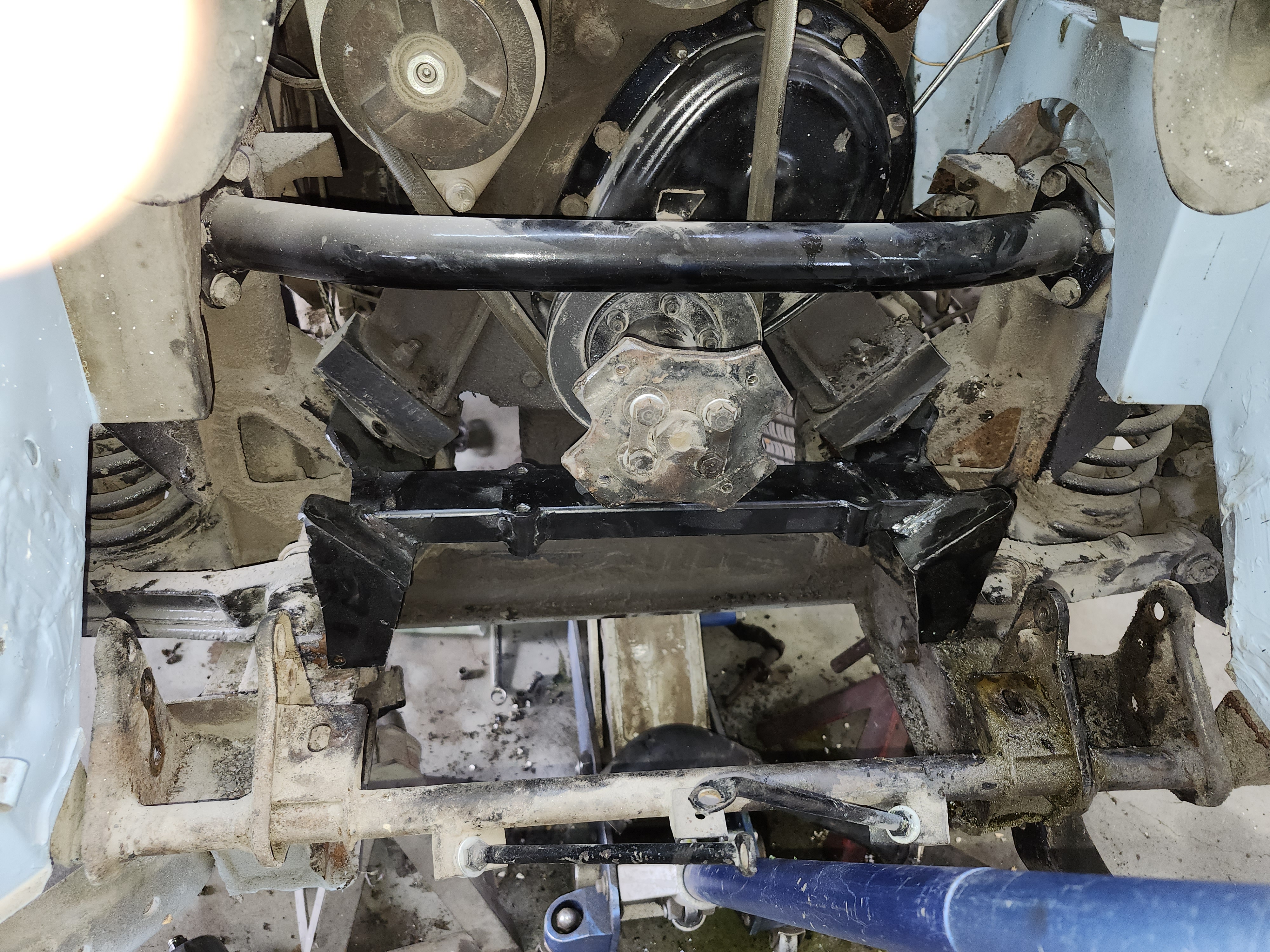

The hard part is completed. the only serious mod was notching the DS tower to allow the U joint
to clear the frame. A half round of 2 inch steel tube was inset into the base of the tower and welded up.
This allows for the standard/plastic fan to be retained as the rack is positioned where the old drag link traveled.
The motor did not mind being lifted the 3/16 for the brackets to slide in. And bump steer is avoided!
Mad dog
Bump steer was the biggest problem when I did my car. It took hours to get that fixed. Good job on planning ahead.
Pics on the install. Hard to see but a section of the suspension tower was cut away and a section of
steel tubing welded in.This allowed room for the U joint. All else used was bolted in. Engine is lifted 3/16
The tie rods had to be shortened.The fan was tight but fit well.

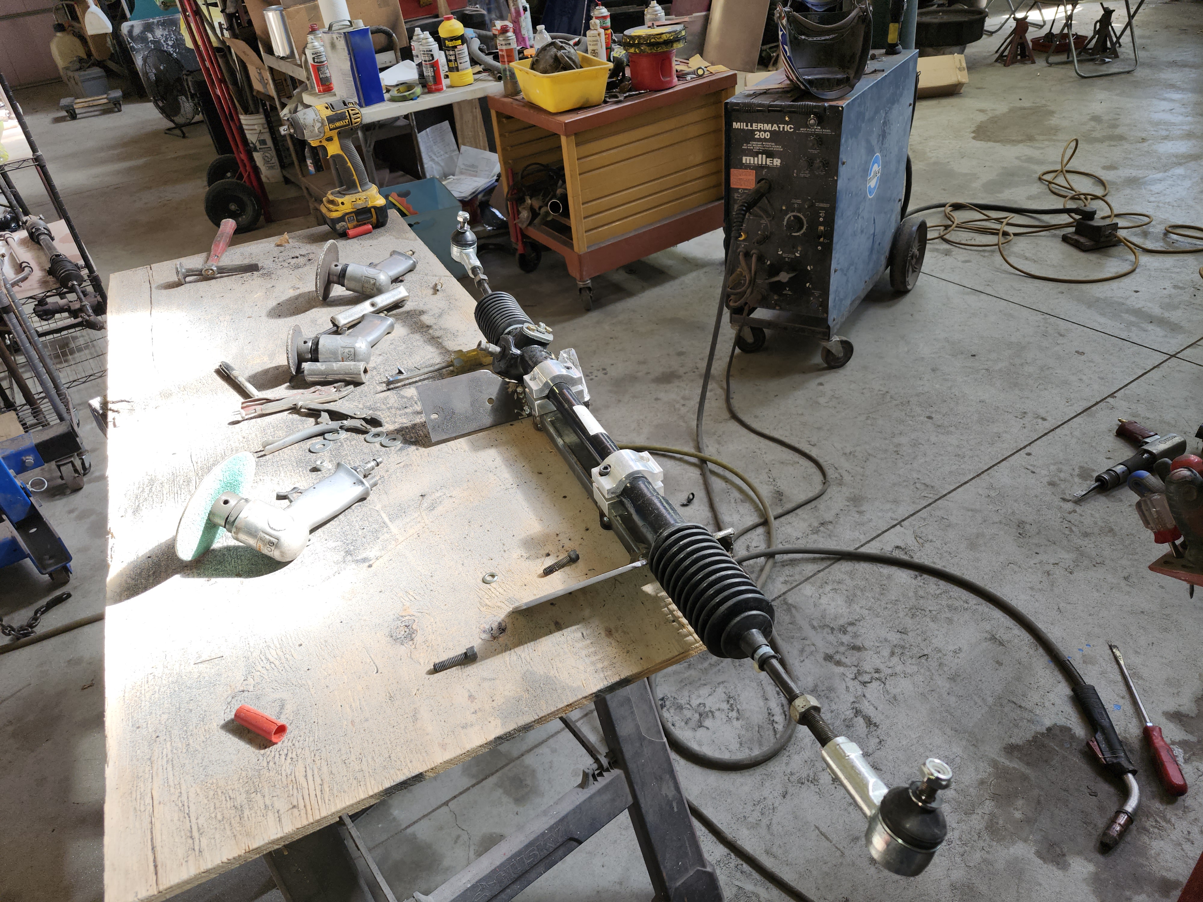

It is called the death wheel. Carbide saw 4 inch blade 1/16 thick. The total was one inch removed from the inner
tie rod end, The outer was shortened 1/8 inch. The alignment has been done and its ready to go.
