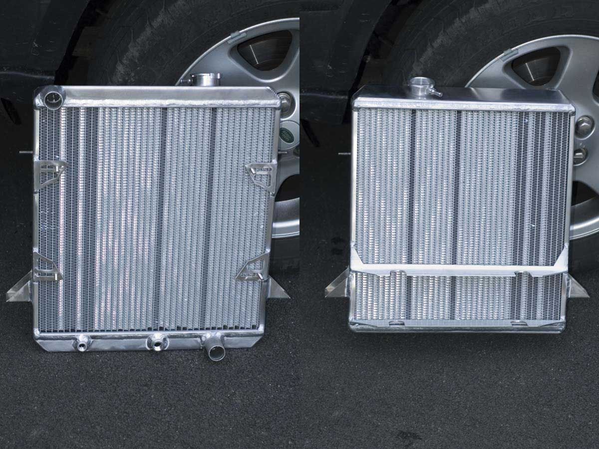

Mine came today. Very similar to Bill's from what I can tell. It's a bit of a thread hijack, but I figured I might as well post it...
