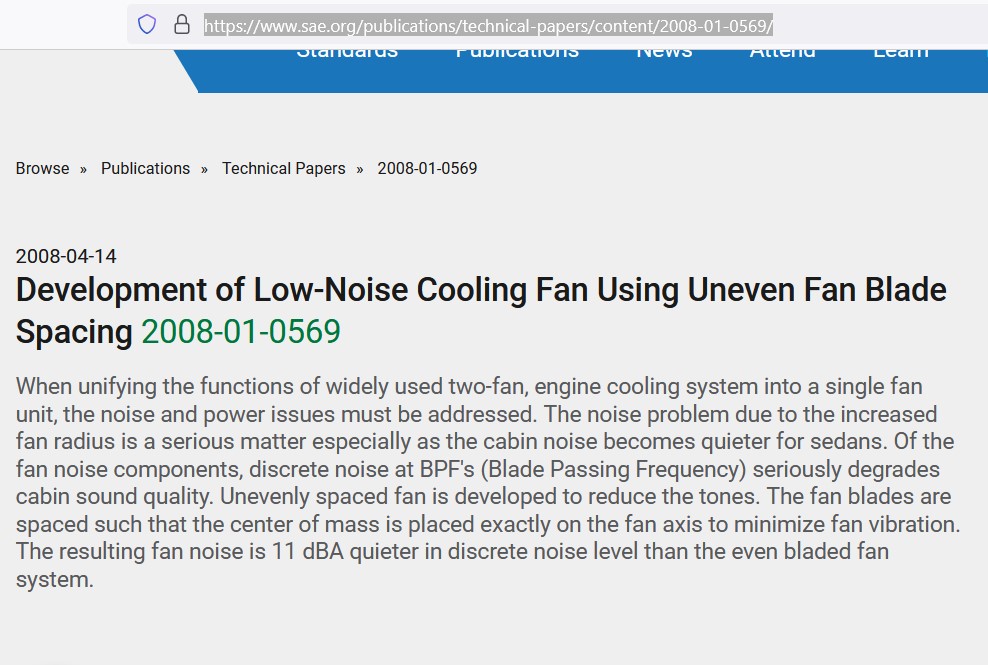

Hello out there,
I just got a Texas cooler and am fascinated with the placement of the blades around the hub.They are not evenly spaced by far.I am wondering about the balance and if anyone knows why they did it this way.Thanks,Ben

Tracy is right on about the cooling. The blades are spaced asymmetrically to reduce mechanical resonance of the blade pulses & reduce noise. The fan is still balanced.

The reasons presented above may have some validity to them, but actually the reason that the blades on the Texas Cooler are spaced the way they are is much more practical.
The blades are spaced such that the bolt heads on the fan hub can be reached with a normal length open/box wrench.
If the blades were equi-spaced, one would need a VERY long wrench to be able to install it.

As far as asymmetric design, most every fan designed in the last 40 years has been made that way for the reason I stated. Accesibility to the bolts is a minor point.

Thats true dave although most use an odd number of blades which produces the same results.-Keep up the good work-Regards---Keoke

I think that the need for quiet fan blade designs has mostly gone away in recent years. Only direct engine driven fans that can run at pretty high rpm, have a noise problem in the first place.
Electric drive fans don't turn fast enough to be a problem. The same with clutch drive fans. Definitely with computer fans.
