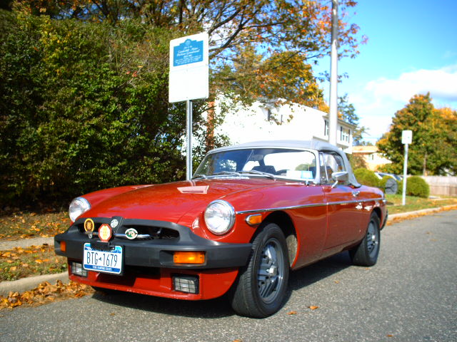

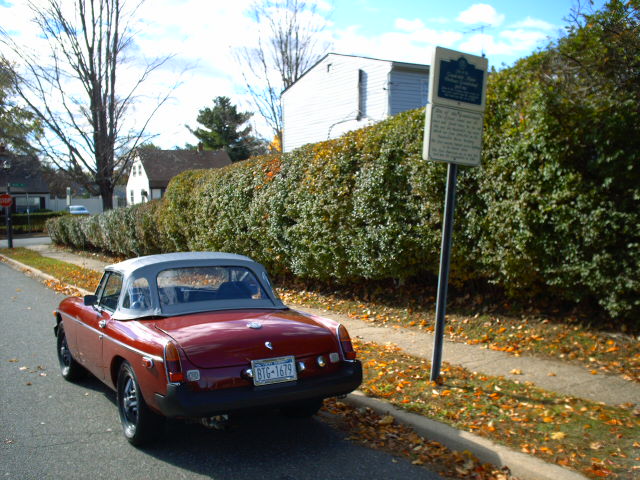

Those are Saab Inca Wheels in Gray Powder Coating. 15" x 6" allows me to get 195s on them and I run a 60 hieght so it doesn't throw off the speedo much. Saab 900 and 9000 wheels to 1987 are the same bolt pattern but they sit a little closer in... nothing that a 3/16 spacer at the rears didn't correct. Saab had a real nice 8 spoke Shelby wheel as an option back then as well. I have a set of them that will be worn by my 73 B when it's time comes to hit the road.
Thanks for noticing Mickey.
