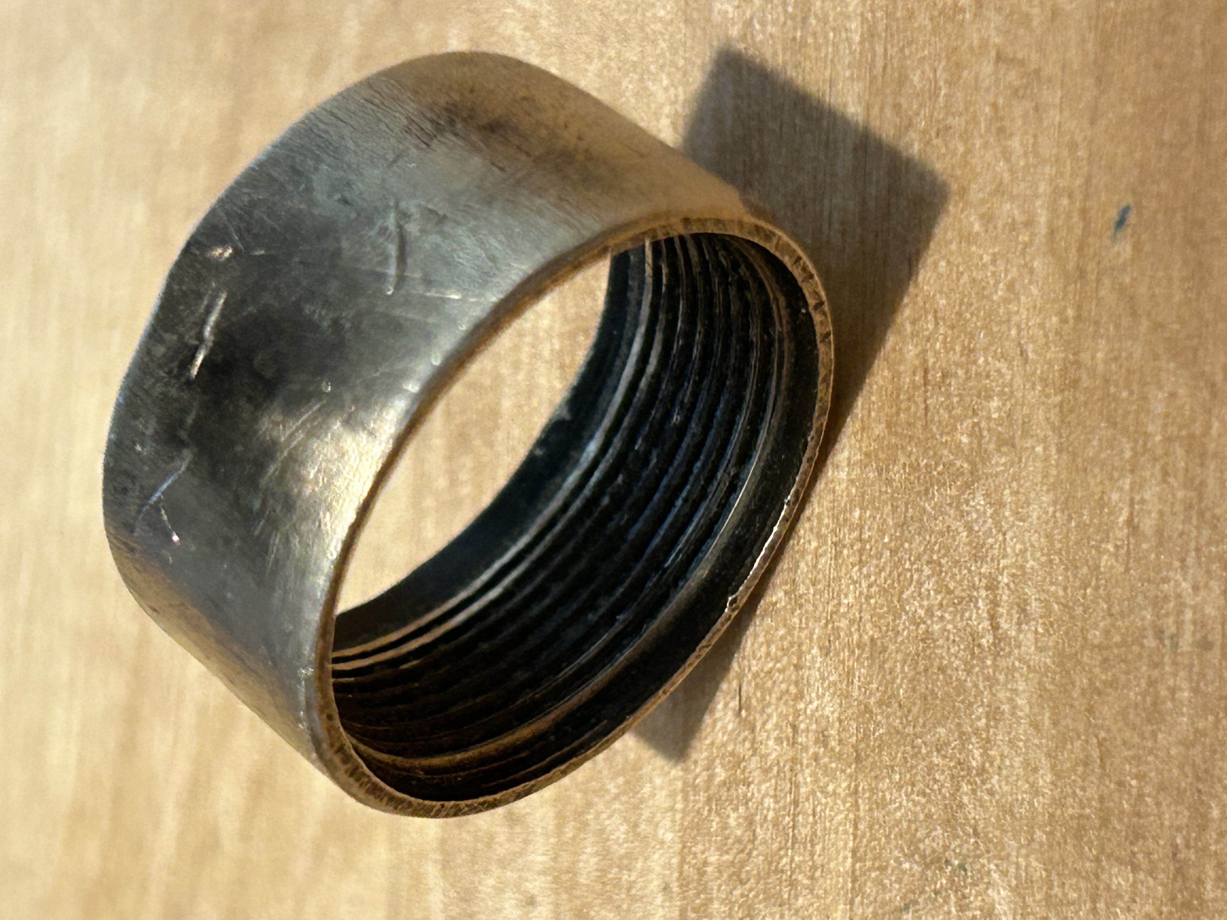

Before tossing the old cable in the trash I thought that perhaps I could repurpose the lower nut into an interesting piece of jewely and after a bit of cutting and polishing this is the result.
