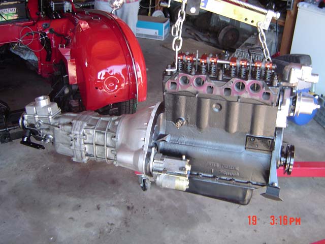

Hi Herb, while you are looking at Gear Boxes for your conversion take a good look at the Toyota Celica box it is very popular with some Triumph people. Here it is coupled up
to one.---Keoke

But does anyone make the adaptor plate that appears to be necessary to match that transmission to the 1800 block of the MGB?
Sierra transmissions would be found in Merkurs here in the States...but good luck in finding one at your local wrecking yard. The Datsun transmission may be easier to find.
Sorry to be late with a reply Rick. I do not know about the adapter plate for the MGB engine. However, the Toyota box is easily sourced in US wrecking yards.--Keoke

Dellow in Australia makes the conversion bellhousing for the celica transmission (W-58). All reports are that it is a great transmission, but it's costly by the time you get the bellhousing and ship it over here. They have a website if you google it.
