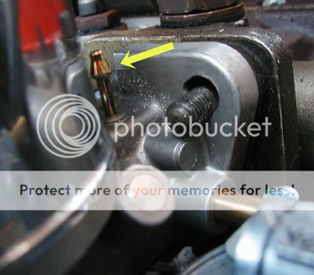

Well, just looking at it, you would think it is ported:
Plus, it looks like a pick-up for a vacuum line rather than, say, PCV, which I think is lower down, towards the bottom of the pic, and, for some reason, blanked off by the factory.
Let me take the carb apart and check that the throttle disc actually covers the hole at idle.

Yes, I think it's ported.
You'll need to remove the carb to see where it goes......another thing, put a vacuum gauge on that port and tell me what you have.

I'd say it's ported too. MIne looks just like that.

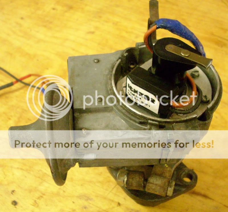

This is how it looks originally. The block between the dizzy and the vacuum unit is the ill-fated electronic unit. Now fitted with a Pertronix:

O.K, wait a minute, you have the Opus (45D4E?) which is completely different than mine (45D4M). Not all 45D's are created equal. I haven't taken one of those down yet, so I can't tell you how much is involved with the swap. Mine is just two screws on the side. IIRC, you have a '79 which should have the 45D4M unless someone swapped it.
Kellysguy,
Yeah, I have the Opus 45DE - it is a 1975 car.
After removing the (defunct) Opus I had to drill and tap 2 holes to mount the new vacuum advance - that's about all that is involved.
OK, at 900 rpm, the "ported" vacuum is 12 inches Hg, 600 rpm is between 9 and 10 and with the idle screw totally backed out it gives 500 rpm and 8 to 9 inches (and the timing drops from about 12 to 10 deg BTDC).
I think the next step is to dismantle the carb (single HS4, brand new) and take a look at the exact location of this "ported" outlet, unless someone has any ideas.
Cheers!
I would hook the vacuum gauge to the carb then slowly ease the throttle. If the vacuum gauge makes a big jump at some point, you have ported. If it increases gradually as you open the throttle, you do not have ported.

The vacuum increases steadily (no jumps at all) from 12 to 18 max, then trails off.
With the vacuum line hooked up to carb and dizzie, the timing goes from about 26 BTDC to way over the scale when throttle slowly increased from idle.
The way it is, I don't see any advantage to this vacuum line - I mean I could set the base timing to 26 BTDC.
