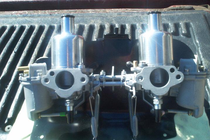

My vote would be for the twin HS2s, I'll be happy to rebuild them for you.
