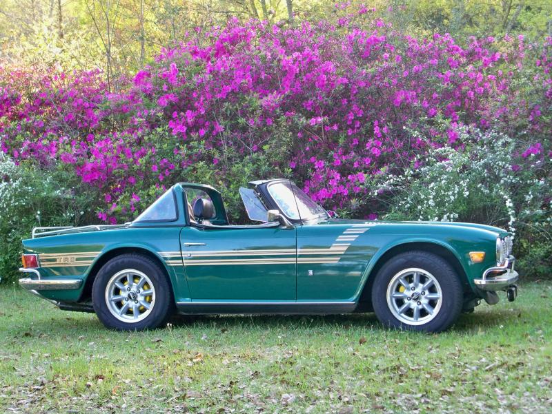

It's my TR6 and a Microplas backlight frame with TripleX glass, but I don't know why the same wouldn't apply to a TR4.
Only on long trips away from home do I install the soft top....it's been like that10 years or more, 4000 miles a year.
I can't comment on any comparisons though...it is what it is and I don't know any different, but it stays in place..and once or twice that was up to 100 mph for about a minute.
Yes, they do deflect the air, at least some of it away from from your face

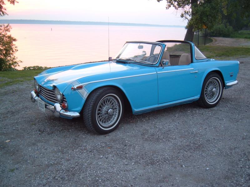

I've had my fiberglass backlight frame on since 06 and love it. 20+ thousand miles. It has never had the hard section installed or even painted. I carry the Surrey top (that's the proper name for the soft top) with the sticks in the boot all the time so if it threatens rain I'm covered. Just be prepared before the rain comes down because you're getting wet. In fact I think it takes longer to put the Surrey top on then putting the top up for my TR3.
As far as long drives it's great. Took me 3 hours to get to TRFs summer party and like charlyf said about the windows is true. My wife always has her window up. Can't mess up that hair doo!
Another concern too if your car is modified and you have a free flow exhaust you'll appreciate the barrier between you and the tail pipe. Had the back light glass out once and took the car on a good drive and I couldn't wait to get home. Couldn't stand the noise! It really made a difference with the glass in.

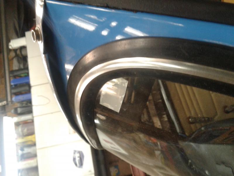

There is a special cap. Just took a pic of it below. The cap sticks out a bit from the frame so the front of the top which has a metal bar sewed into it can attach to it. At times if you don't get it fully under the edge and once you get to 40+ mph it can pull out and flip up like what you would flip the brim up on a baseball hat. Someone at one of he TRF parties showed me where he carries a can of glass cleaner and strays it up the edge for lubricant that eventually flashes off but it helps to get the top tight under the edge. It works too! But I still have to use the pad on my hand to really push it under the lip.

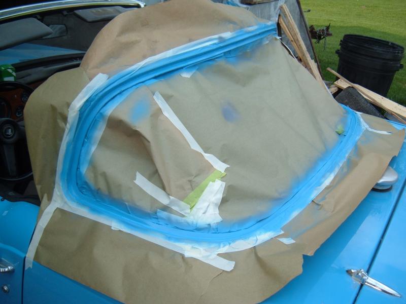

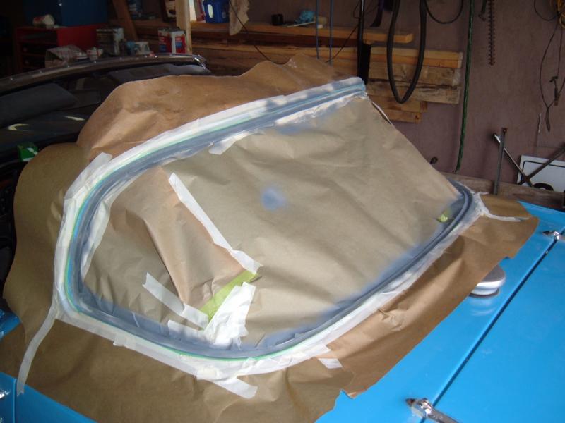

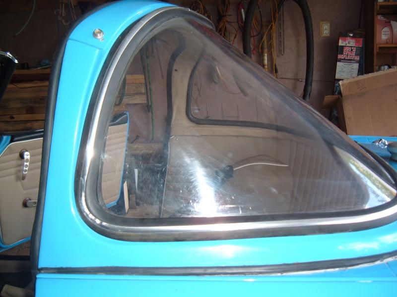

It's a long story how I got mine but it came from a guy in Kentucky that I helped not get schemed from a Ebay seller selling top he didn't have. He happened to stumble onto 2 of them and I got one. But it's a fiberglass one from way back. Took a lot of rebuilding to get it to work because the previous owner had ground off most of the lip that holds the glass in and I had to rebuild that.
