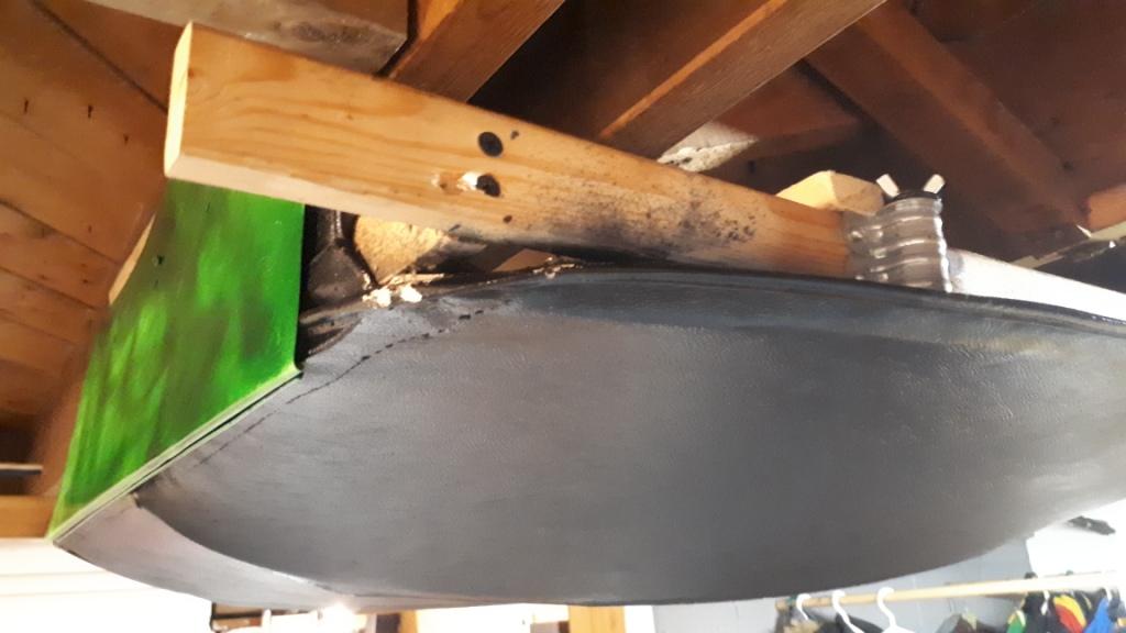

Not related to the problem,
I made a frame to hold the top taut in the off season.
It hangs upside down from the rafters, by the 'gutters' on each side (green 'hook'),
to relieve stress on the snaps & keep gutter stretched evenly.
