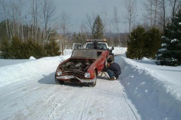

One more reason why you will never see the Banana on those white roads!
Heck, look what happened to me on an 80 degree, sunny day while sitting at a stop sign? Go out on snow and ice??? Fugghedduhbouttit!!!!!!!!!!!!!
