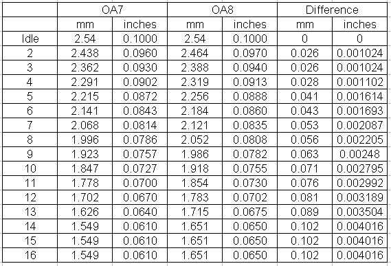

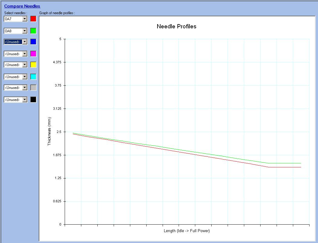

I have OA7 needles (1.6" long) in my HS6 carbs--measuring at the tip, in the middle and at the shoulder I came up with .064", .080" and .100". I would like to get needles that are just a bit leaner, perhaps about .002 throughout the scale.
I can't find the OA7's on any of the online needle charts and wonder if anyone can make a needle recommendation.
This is a plot of the OA7 verses the OA8, the OA8 gets progressively leaner with throttle position.

You could always just call Joe Curto, I'm sure he could fix you up. Nice to finally meet you face to face last weekend.

I found this program online at:
https://www.mintylamb.co.uk/suneedle/
but it did not have info about the OA needles or several others that I knew were close to it for that matter.
I'd appreciate knowing how and where I can access the program that you used to send me this info.
It is WinSU . I can give you whatever data you want or setup a go-to-meeting session and give you control over my PC so you can look yourself.

Thanks for the reference and I have downloaded the program though it looks like I need to register it for a fee in order to get the full functionality which includes the needle comparison program. I will investigate furthe and thanks for the kind offer.

I raced last weekend at Kershaw SC where it was quite cold ane with these new pieces in place and using last year's needles (KD) the car was running quite rich. I had a set of (leaner) OA7's and they helped a lot, though I still had to raise the jets a bit from baseline, and since it was so cold down there I figured that some leaner needles would be in order.
I just called Joe Curto who verified that yes the OA8 would be the next step leaner, so I ordered a set of those. I currently have a set of the red (4.5 oz)springs installed and am not clear on how going to a heavier or lighter spring affects mixture. Do I understand it correctly that a heavier spring slows the rise of the piston and therefore lets in less air and makes the mixture richer, and vica versa for lighter?
