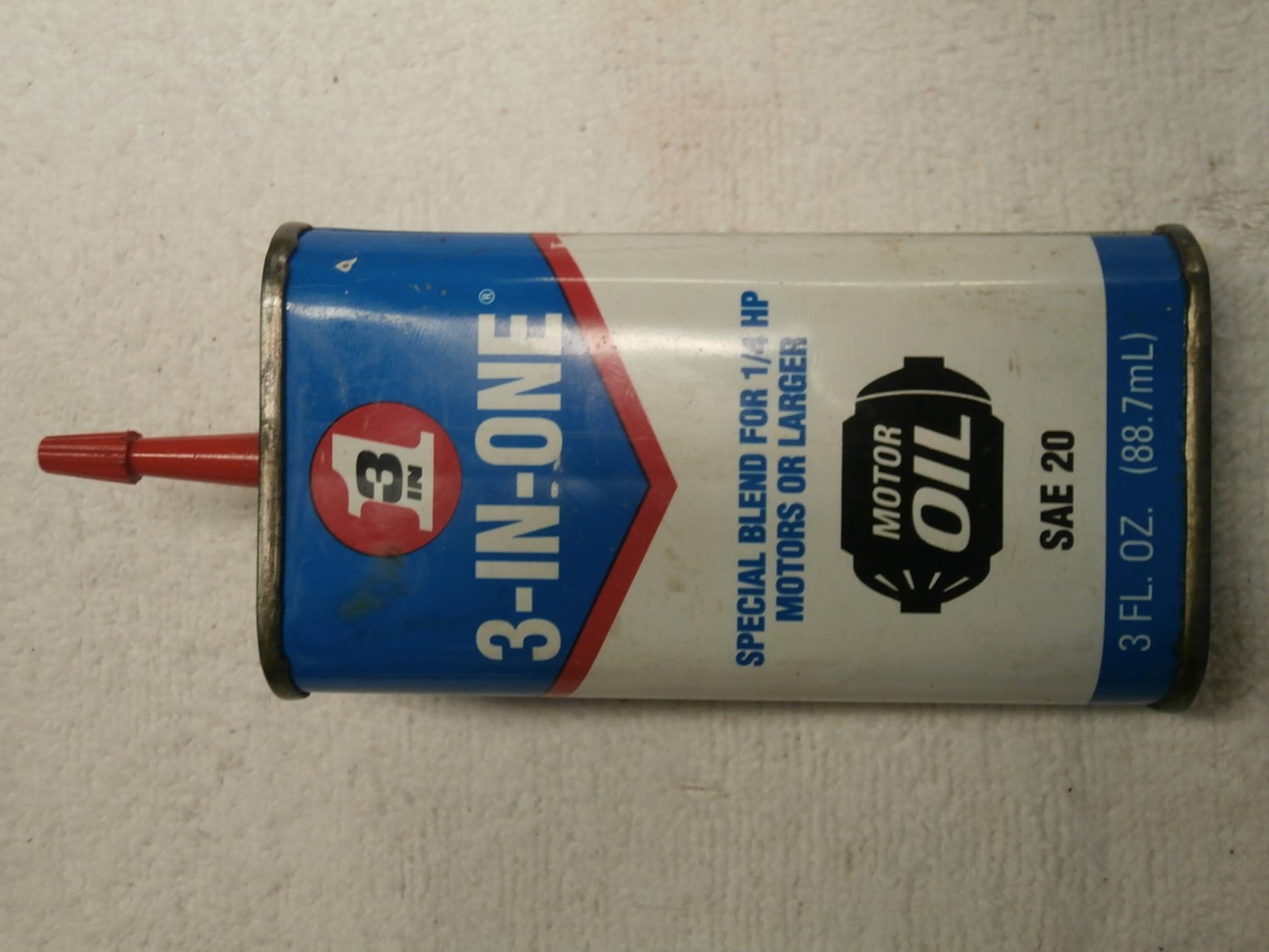

I use 3 IN ONE Motor Oil. I am not taking about your normal 3 In One multi-purpose oil.
This stuff is a 3 IN ONE product that comes in a blue / white / black can rather than the normal multi-purpose oil that comes in a red / white / black can and it an be found at most hardware stores or on Amazon.
It is SAE 20 weight and is advertised as being for 1/4 HP or larger electric motors.
It comes in the standard 3 IN ONE can with the nozzle that makes it easy to put in the dashpots.
