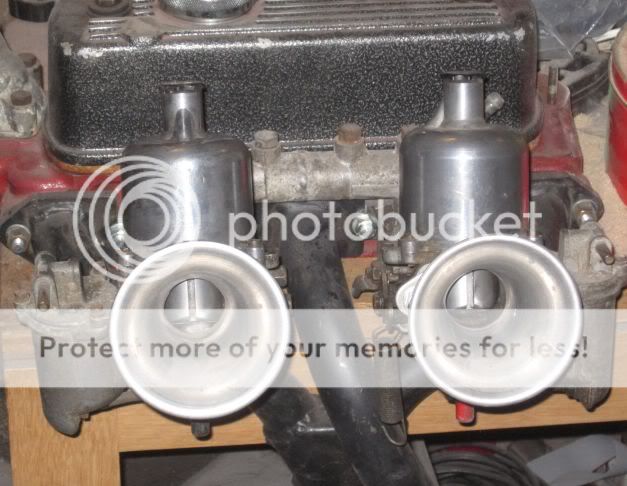

Rebuilding my SU carbs and I found:
- a ball bearing blocking the short 5/16" rubber balance tube that's between the body of the two carbs
- homemade gaskets between the damper piston housing and the body of the carbs
It's obvious these carbs have been worked on before. Any thoughts about the ball bearing? I mean what was someone trying to do here? And since the kit didn't come with the damper housing gasket (part breakdowns don't show it either) I have no plans on putting one back in.
It sounds like you have late model carbs on an early engine. The early carbs didn't have those tubes, so the ball bearing may have been a convenient means of blocking off the tubes.
I still trying to determine what kind of Frankenstein I have,

As Trev said it sounds like those are late model 1275 carbs which are perfectly good and will make your car do just fine.
As far as I have ever heard the dashpots have no gaskets. If you want the car to leak a little less you could hook the 5/16" tubes to an engine breather and simulate a PCV system. Won't hurt anything and will save you some oil.

Thanks for the carb pic. And I agree, that cam box is likely just a box. Great idea to use those tubes for a breather,
