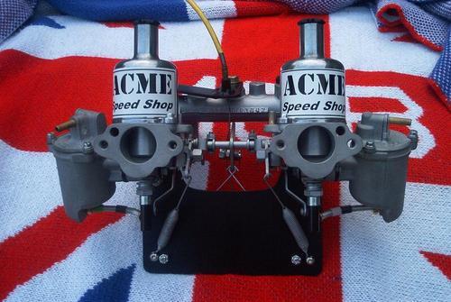

Here's a set of HS2s I just finished for a SCCA racing Midget, custom heat shield relocated, custom throttle cable bracket, no choke linkage, not needed for the race car.

The only reason I do the alternate heat shield on the race midget carbs is for the funky header designs racers use, racing headers are a whole different game than street headers. For street MGB carbs I normally use the stock heatshield, it's a good design. Could I, sure, but it would hard to make something better than a new stock one for the money.
