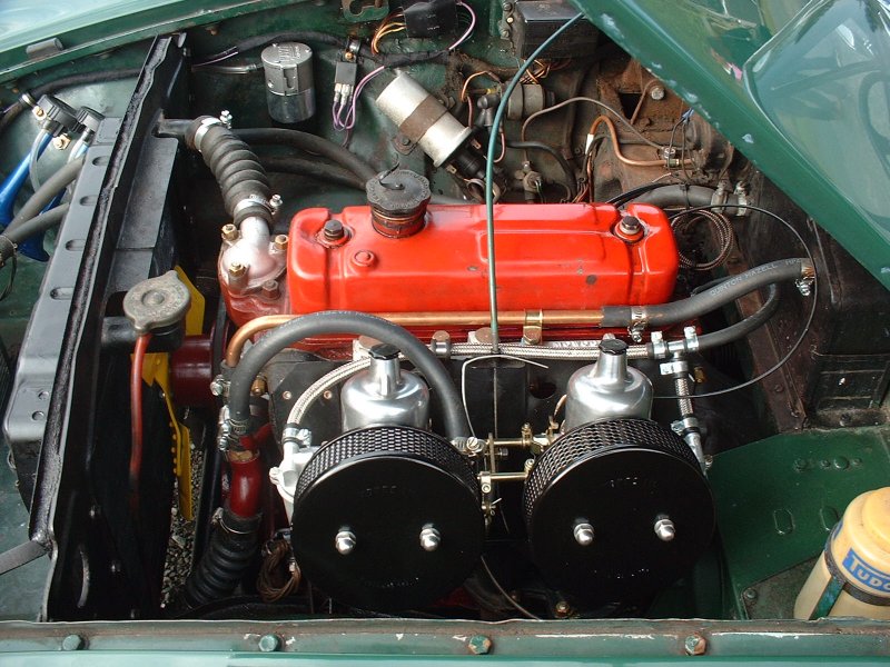

Well, I have an HS setup, but its not on my car yet. But I try to attach a picture or two from the net.
From what I've read you will also need to change needles if you run K&N filters on your set up. Burgess suggests #6's for HS's and ABD's for HIF's.

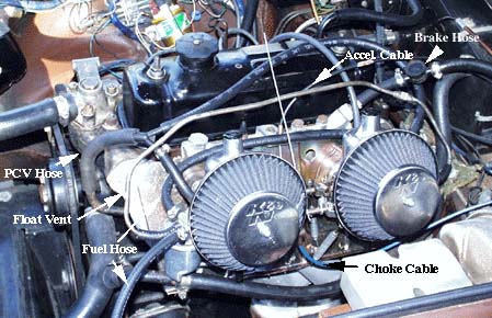

and the second attachment.
I too would really like to see some GOOD pictures of some of the members carb setups so that I too will know that I'm conecting them correctly when I go to switch over.
Thanks for the pics. It helps a lot. Shouldn't the air filters have a cover? What color is the heat shield supposed to be? I couldn't quite tell from the pics.
Cheers
Rick
The air filters are K&N's - I believe that they're supposed to be that way (but I'm a new guy here, so I'll bow to the opinions of the more experienced members).
The heat shield, as I recall, is silver colored metal and is a bit discolored from the heat (the car's buried behind a lot of stuff right now) - but I have no clue about it's original color. I'll try and dig it out for a better look later on this week (and more pics).
