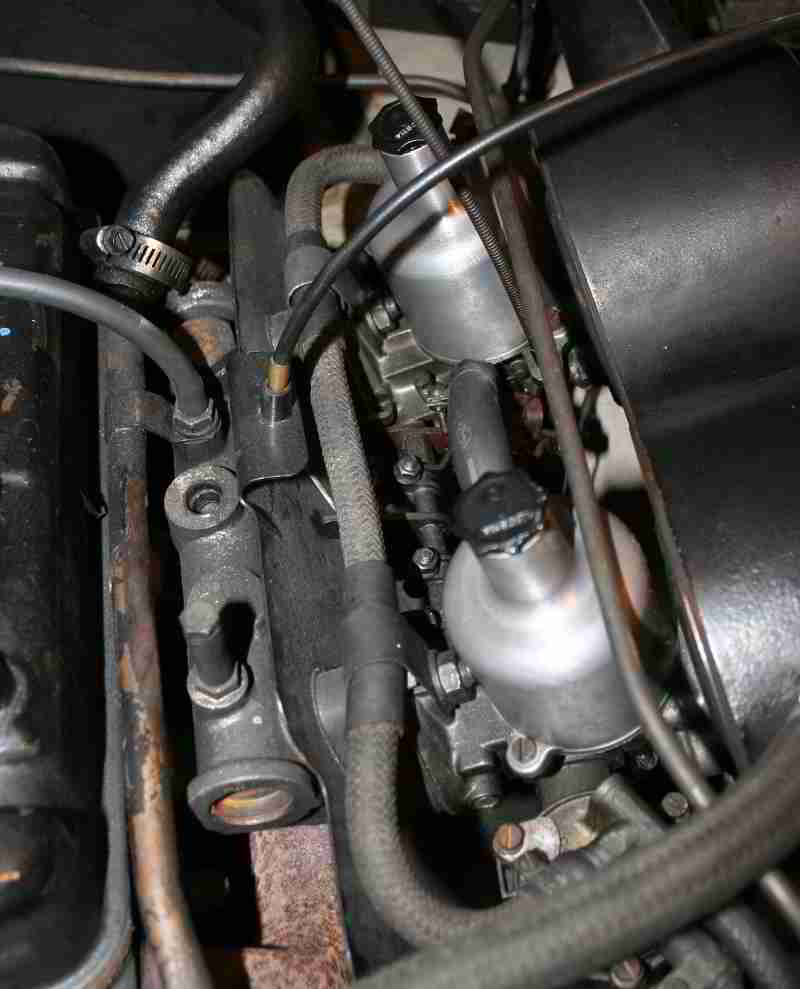

Here is a picture of ncbugeye's HS2s... it's a pic I have posted before but it shows what you should be looking for.

THanks fellas. Chris, I notice that you do not have a pgr valve on the top of your mainfold. How did you vent the timing cover? I have a manifold that does not have any of the added holes on the top of it and would like to use if it will work. I believe it is 1 1/4
Boz, I'm old school, so I go with the early nonsmog HS2s, the one pictured above are the smog model carbs, notice the hose running between the two carbs, the early one don't have those and also have non poppet valve butterflies. Oh and that awesome carb rebulder in SC, also has a boxes full of SU carbs, probably a hundred plus carbs, and he'll take your smog carbs in on trade if he's doing the rebuilt on your carbs, call me when you get ready.

Hap, I'm not sure whether I should be worried when you say I have the "smog" carbs. Are they a bad thing? Should I be doing something with them to make things different/better?

Chris your carbs are fine, the later HS2 smog carbs, have the side tubes like in your picture, if you're not running smog and it looks like you not, get rid of the hose in between, and plug the brass tubes off, also these carb have the poppet valve butterflies, so in a rebuild we can get rid of those and istall solid butterflies which inproves flow.
