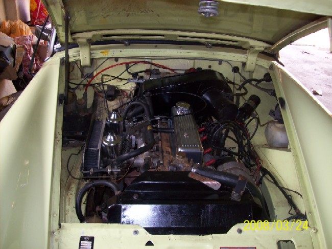

Down here in Johannesburg -My 1500 Midget is from the UK I shipped it out in 1984. It has twin SU's and I put a K&N filter on. Attached is a picture of the engine bay, you can see the twin SUs and the K&N filter.

Very cool,
I would think that to be the ideal conversion to ditch the Stromberg for. Thank you for sharing that SU's were used on late models (75+) out of the US market. Learned something!!
Re: SU- Can the throttle shafts be sealed or bushe
any usa model converted to Twin Carbs needed a notch cut out of the wheel well to make it fit - any that I have seen that is
Yes, as JP says... something to do with LHD vs RHD configuration of the engine bay, as I remember.
