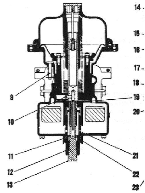

The jet adjustment sticks out of the bottom of the float bowl, item 13 below. On the later 'emissions' carbs, the needle adjustment is hidden inside the damper and takes a special tool to turn.
I have these, not the later emissions carbs,
