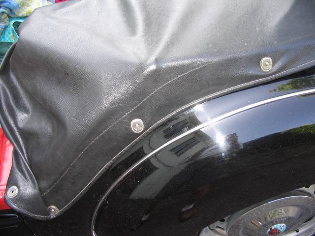

The tonneau cover on my TR3A is original. I leave it on all the time. In the last 18 years, I would guess that I've had the top up or the hood stick cover on for less than a few hours - mostly at TRA, VTR or other car shows. Because the cover is always snapped into place on the car, across the back, there is no shrinkage there. When I park in a public place, I close the doors, pull the cover up from behind the seats and snap it along the top of the dash. It's a tight fit and I have to pull it a bit, but it goes. Then I snap it closed along the doors.
Because it's tight at the rear and on the TR all the time (see photo), I feel that this may be the solution.
