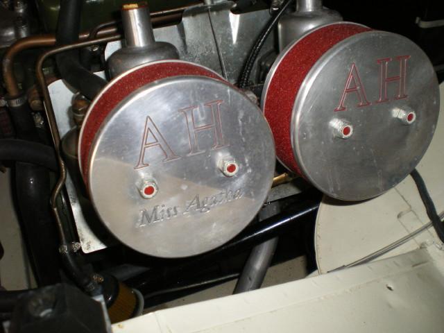

Does that mean you are still using the stock filters, Jack? If not, why did you change them out and what did you replace them with. By the way, thanks for all your help, Jack.
Here is what I changed to, neet?

I find that the stock filters are fine for removing microminiature particles like dead squirrels, buffalo chips, pianos, and falling meteorites. Anything smaller, though, goes right through them. That said, I use them, because they look really neat. Still, the time may come that I replace them with something more effective. Just one more thing on the list.
