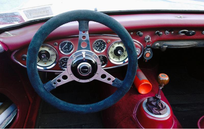

Ya know I have forgotten how I did mine. And I have been planning to turn my steering wheel 180 degrees to get the center spoke into the straight up ( 12 o'clock) position because with it the way it is I can't see the gauges that well. So can't we just unscrew the perimeter screws that fasten the Moto-Lita wheel to the hub and then position the steering wheel where we want and reinstall the screws?

I suppose undoing the perimeter screws and moving the wheel would work if you got lucky, but my guess the wheel will never line up when you move it around the hub. The Moto-lita wheel is beautiful, but it's a "T" shape rather than the "Y" shape of the original wheel. No matter how you flip the Moto-lita it's going to block the gauges. That's the beauty of Mike Lempert's wheels. They're works of arts that let you see the gauges.

If you have a Moto-Lita you could try unscrewing all the little screws holding the wheel onto the hub before you take
EVERYTHING else apart. It worked for me. Becareful you don't scratch anything.
