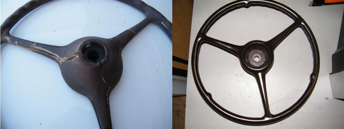

I did the wheel for my Prefect with PC-7 epoxy. It's a little easier to work than JBWeld and being all plastic, seems more appropriate. My paint supplier mixed paint to match the bakelite dash and added the right amount of dulling agent to also match the sheen for a beautiful match. The whole process can be found here https://enfoprefect.org/cars/Prefect_Steering_Wheel.html. These are before and after.
