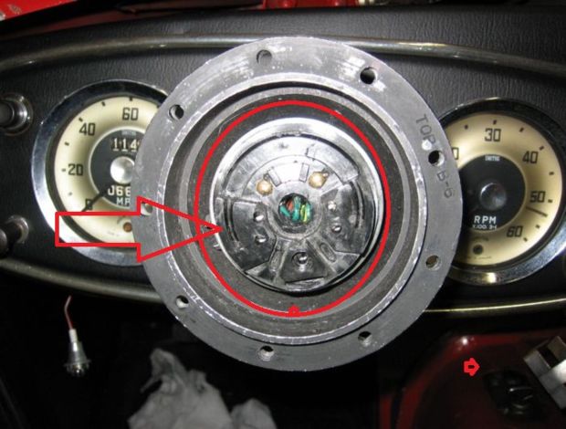

Hello
The picture is my steering wheel.
Direction Indicator is unloaded.
In the middle of a visible part of the black I do not get nothing out of it.
Screws that can not be found.

OK, I'm confused. What are you trying to remove (the steering wheel is already off)?
Are you trying to get the trafficator (turn indicator) mechanism out? If so, and it's a non-adjustable steering wheel hub you have to remove the brass nut and olive on the steering box, then pull the trafficator out with stator tube. On an adjustable, the trafficator mechanism is on a separate shaft and you can just pull the wires through the stator tube.
The steering wheel hub--the outer part--is held on with either a circlip (adjustable) or nut (non-adjustable). Once the trafficator is out you'll see one or the other.
Your trafficator looks correct. The photo shows the base of the trafficator, where the indicator lever and the canceling mechanism mount. Be carful with it--it's next-to-impossible to find NOS and the repros aren't very good.

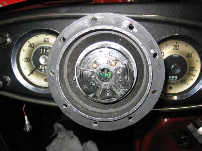

Hello
Excuse my bad english language.
It's a non-adjustable steering wheel.
Direction indicator base trying to get away.
Is it the one attached?

Bob_Spidell said:
... If so, and it's a non-adjustable steering wheel hub you have to remove the brass nut and olive on the steering box, ...
Look at the picture on the site of Moss USA; https://www.mossmotors.com/Shop/ViewProducts.aspx?PlateIndexID=28891 Numbers 38 and 39
Both are near the radiator in front of the engine.
The part you try to take out is held bij two screws from the back. (see the link to www.healey6.com on pictures 5 and 6) So you have to take the complete part out to be able to loosten those screws.
Taking apart is no rocketsience, putting it back sometimes is
Hans
Hello
I think now I understand :crazyeyes:
So I need to open the screws 38 and 39
And then the direction of turn indicator that the bottom
should go off.
Thank you for your help.
