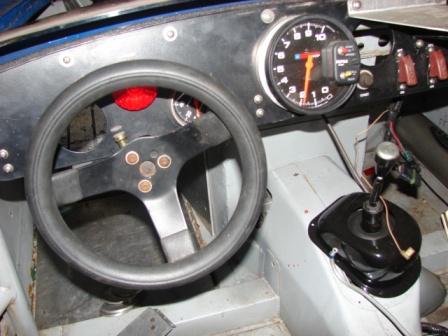

Summit has a fairly comprehensive line of Grant steering wheels in various dameters. It's what I run on the race cars.
Jeff

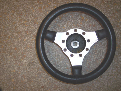

I just recently got a real nice 13" alum. wheel off ebay for under $50! Keep looking there, they do come up!! /bcforum/images/%%GRAEMLIN_URL%%/thumbsup.gif
