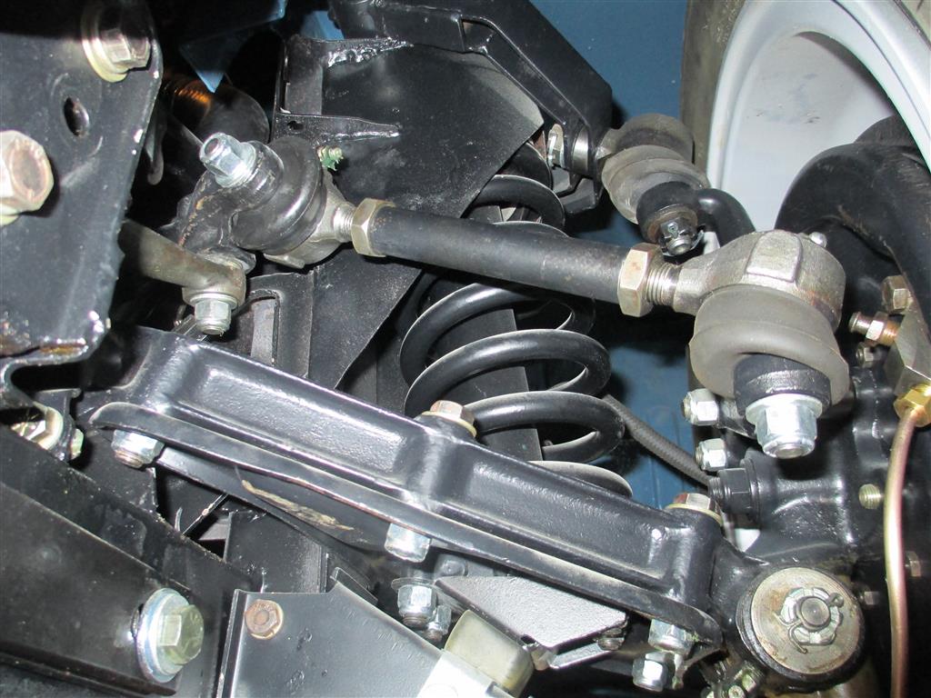

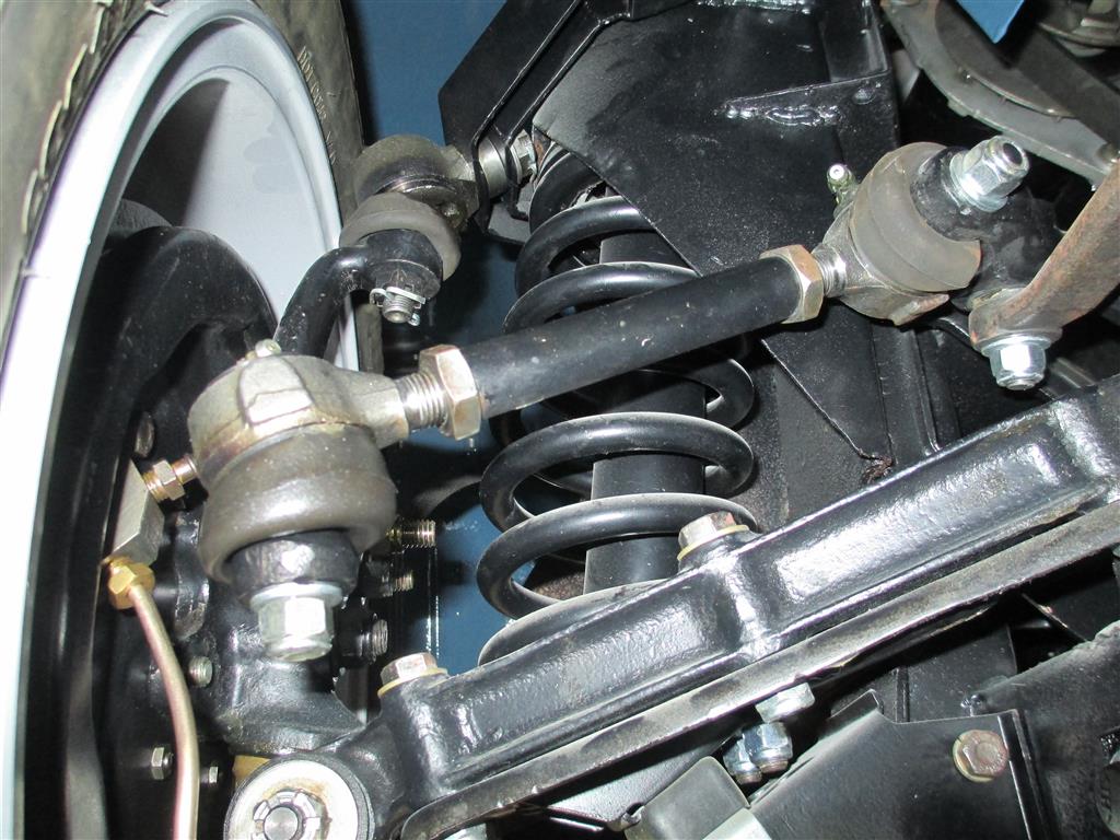

Thanks ... one more thing to check. Just got car jacked up, but out of time till Sunday to investigate further. Anything look wrong in these pics?
Yeah, I can see a problem - dust on the top of the coil springs! Looks very nice Mike. Nothing seems out of miss there at all, and everyone has hit anything I could think of - John mentioned the one that caught me before, and that was a bent vertical link. But with my car that also showed up with a very worn trunnion and a lot of play in general. If you don't mind messing up your toe in, it might be worth disconnecting the tie rods on each end - that should let you feel how the steering box and idler arm feel by themselves. You could also rotate each wheel separately as well and see if one side or the other is binding.
