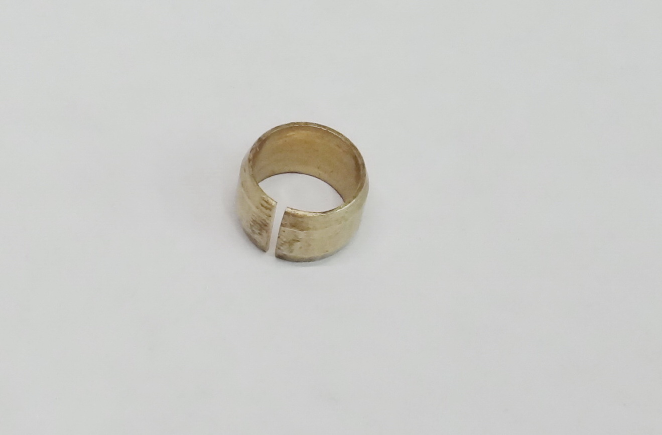

I'm reinstalling the steering components on my TR-3A and have a question about the "olive" that fits on the end of the stator tub. Among the parts I have is a bag with what appears to be a compression fitting. It's a bit strange though because there is a split in it. If it's supposed to "seal" the bottom end of the box, why would it be split?
It's labeled with the correct Moss # 667-055 for a compression sleeve. I didn't participate in the dis-assembly so I don't know for sure if this part actually came out of my car. Anyone have an opinion as to whether or not this olive, with the split, is correct?

The split appears to be as original, and gets clamped shut when installed. At least, mine has it too and doesn't leak. Well, not much, anyway :smile:
I think the split is so you can get it apart next time and reuse the olive. Modern solid olives crush into place and usually cannot be removed without ruining them. They also don't fit the TR3 steering box.
