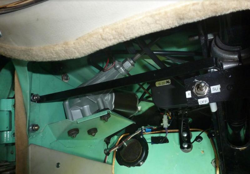

A friend realized he was missing this and made one from hardware store flat steel.
He reports it has reduced shake and play in his steering. Lack of this brace might be a contributing factor in the infamous scuttle shake.
Dimension is 11-7/16" on outside of bends.
Refer to Moss "Front Body Fittings 100-6, 3000" page, item# 200
