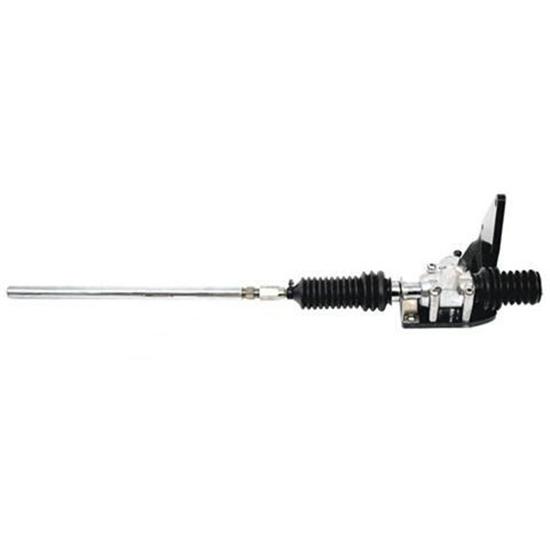

There's a chassis mounted unit made by Unisteer that the hot rodders use with Ford solid axle setups. It mounts to the inner left frame rail and has a single drag link to the right spindle. The 28-32 Ford version has the shortest link, but that is easily modified. You would likely need to do some minor work to get a Morris end link to fit. One source is Speedway Motors but other stores carry it as well. https://www.speedwaymotors.com/Unisteer-1928-32-Ford-Cross-Steer-Rack-and-Pinion,2033.html

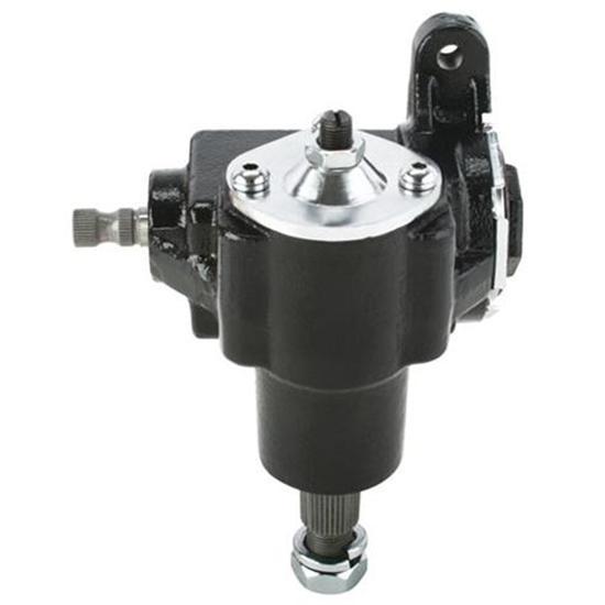

A more conventional, common and compact box is the Chevy Vega unit, also available from Speedway. It's also very popular with the hot rod crowd because of it's small size and low cost. Either system, if you could fit it, would be a vast improvement over a Bishop cam steering box from a TC.
