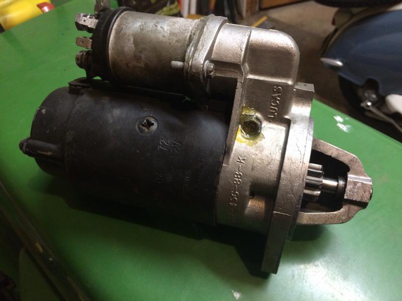

My original starter finally gave out yesterday.
I bought a new Denso as a replacement.
I'm struggling (really struggling) to get the top bolt of the starter out. Since the bolt head is behind the firewall how do you keep it from spinning?

Update.... It's OUT!
I went "low-tech" and slid a wooden paint stirrer like you get at the big box store. It was thin enough to fit between firewall and transmission. I'll try the claw wrench to tighten.
