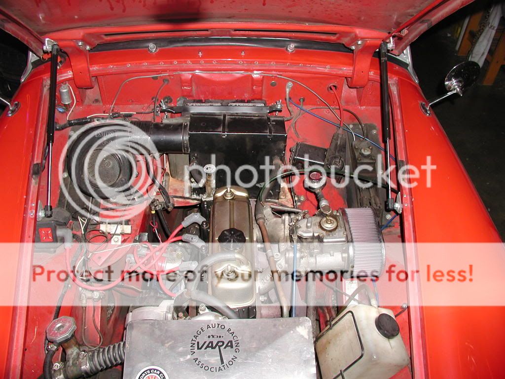

After receiving all the great advice on the alternator options a few days ago, I thought I would throw this one at you as well. I would also like to replace the starter. It seems logical to do both jobs at the same time.
As noted, the car has a 1275 with a Rivergate/Datsun tranny, installed by PO. Searching the forum, it seems my options are:
Stock starter
Gear Reduction from one of the vendors
1989 Isuzu Trooper II 2.6l starter #17155
Question: It seems that the stock starter requires the Datsun bellhousing to be modified. It seems likely that the car has had this done, but I am hoping a few (poorly taken) photos will help you all to confirm it. If you can tell, does it look like I have a stock starter:
If it looks like that is the case, and that the Datsun bellhousing has therefore been modified, should I replace the starter with another stock item (or rebuild)? Would there be an issue if I changed over to one of the other starters, considering the alteration to the bellhousing?
Again, any assistance is greatly appreciated.
Thanks in advance...

I would prefer to upgrade to a modern starter, but was concerned that the Datsun bellhousing had already been modified to accept the stock starter.
Would changing over to the Isuzu starter create an issue with the modified bellhousing?
if the stock starter bolted on, then the isuzu well bolt on, also check clearence on the fire wall,
I think not, however, the only upgrade is a geared starter and a street engine does not need one. The orginal starter is fine and is bullet proof. In 30 and years only had one go bad.

MONEY SHOT!!!!!!!!!!!!!!!!!!!!!1
Baz said:
That hole is already cut out Bill, so you may as well use the stock starter.
That's my inclination as well. Just thought I'd get some input first.

the hole in the case is because the stock unit PULLS the bendex into the ring gear and the gear reduction unit PUSH OUT. The hole in the case is only cosmetic. There is nothing that needs to be sealed in the area. This according to Paul A. when he put the 5 speed into "the red thing". I chose the gear reduction unit rather than the hole, just because.
