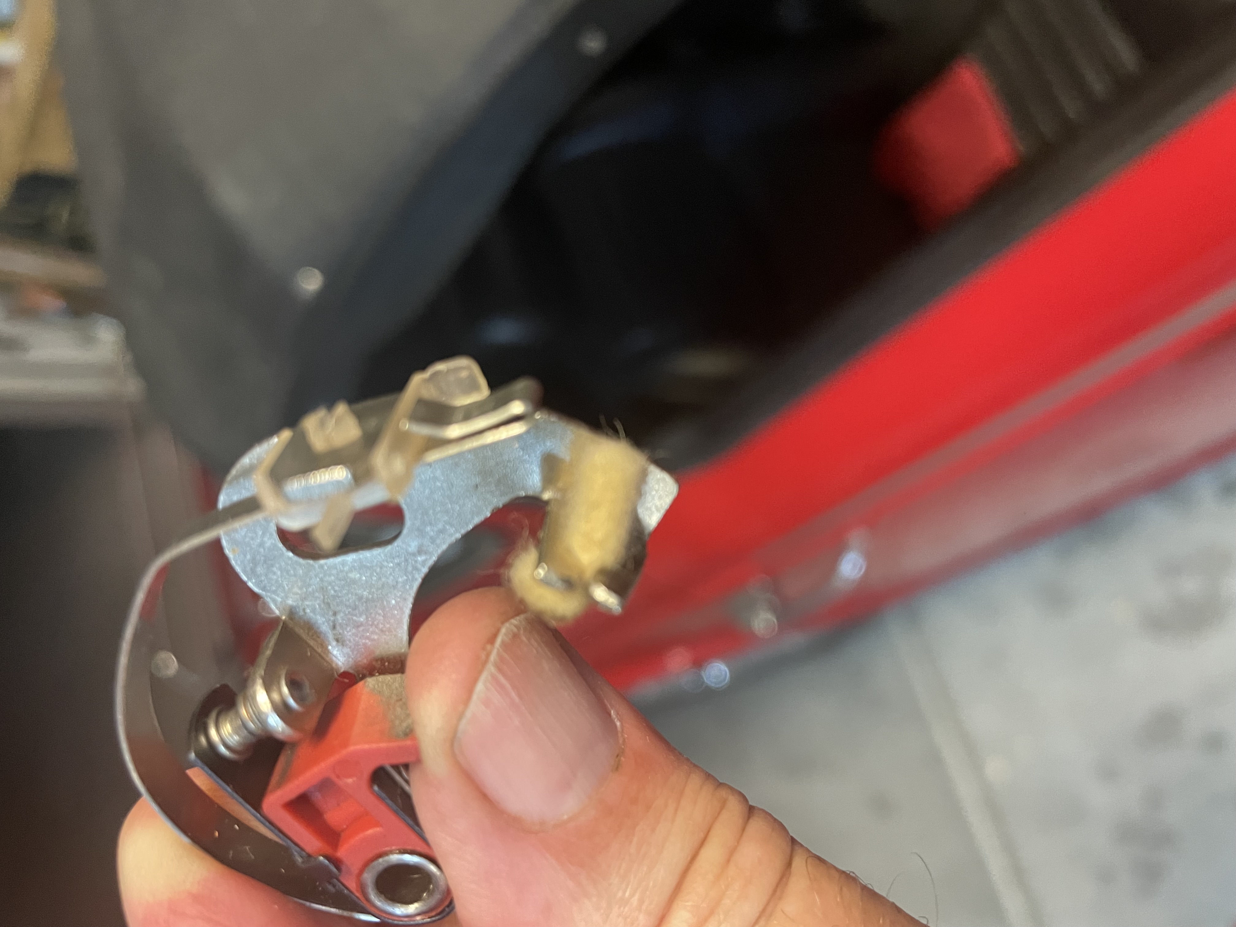

My points, incidentally, were only slightly blackened, and had no pitting. I could easily file and make new. One note: I am using a Race Distributor, and it does have that little funky spring loaded clip to hold the condenser and coil wire. I don’t particularly like that set up, as the wires, in my view, are a little too close to ground. See pic.

Part of your answer.
I had a friend with a Austin Healey who left the key on for maybe an hour ( by mistake). It burned up the wire from the coil located on the back of the distributor. Coil was hot as well. We had to locate a substitute replacement part to get him going.
When eat of the coil and condensor died ( as did the car) I only replaced the single part. And back on the road!!
Charley
To answer your question: if you do anything to the points you must recheck the timing. In theory, if you got the points gap exactly as it was before working on them, you wouldn't have to recheck the timing. But that never happens.
Also, if you have a very hot coil (let's say, too hot to leave your had on it more than a few seconds) something is very wrong. Either the coil has failed or you have a coil with too-low primary resistance. I also don't like the practice of throwing parts at a problem, but there is no reliable way to test a coil. You have to substitute a known-good one.
