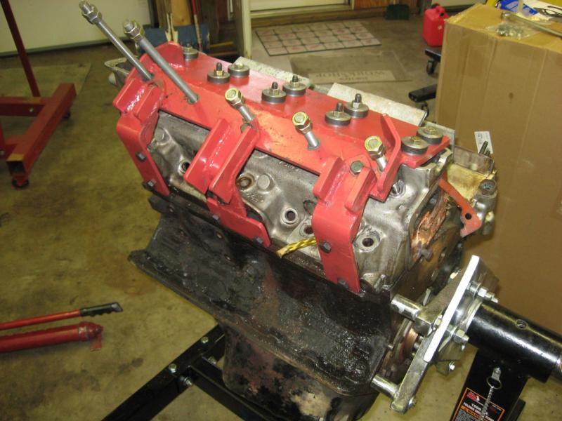

IMG_0221.jpgHey Randall,
I have the Head Removal bracket tool in my garage, pulls any Stag or TR7 head with zero added damage. You pay round trip shipping to get it if you promise to turn it around in a few weeks.
The tool has been used on dozens of engines, works even with broken and fully seized head studs.
Typically it only takes 1-2 hours per side considering unpacking, setup, pull, change sides, repeat, then clean up the all-thread ends for the next use and repack.
When you have the top end engine parts clear, call me for the shipping details for supplying the label and I will ship it off to you. It works best with the engine out, but if you pull the brake booster and booster vacuum accumulator, you can pull the heads with the engine in the car.

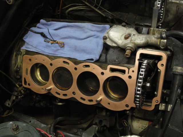

BTW, we have several Stags running around with solid copper head gaskets, thickness is custom adjusted when made to compensate for head skimming to restore back to OE head heights.
The Motorway in Ft. Collins had the pattern copied from a new OE gasket I supplied at https://www.cometic.com The gaskets are available in the standard configuration right now, when I get a RoundTuit, I will do one that covers the exposed aluminum water jacket block side exposure from where the OE gaskets have too large of holes not matching the head. these are available in a range of thicknesses for about $160 a set. They should still have the pattern in their system, and Frank at the Motorway says the fit was perfect. You anneal (soften) them with a propane torch, cool, then spray evenly with copper tack sealant.
Nice thing about these is, you reuse them if you remove the heads in the future. Of course, having a 90 degree square intake manifold to 90 degree cylinder head intakes with correct intake gaskets is important before bolting everything to torque.
Thanks, Glenn. That's my backup plan (but I still think having a working portable EDM would be cool).
