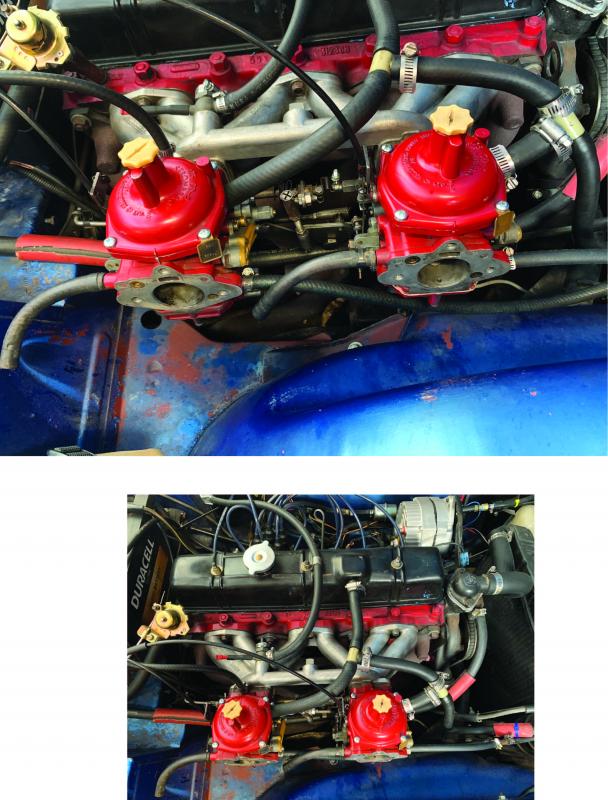

A picture of what you have would be helpful.
Picture 1975 TR6.jpgattached. Two more clues. Disconnecting the brake booster (sealing the ends) didn't make any difference. Also didn't make any difference to braking feel - replacement booster due later this week. Better clue - definitely more power and no sputtering with the choke out 3/4 of the way to max even after the engine was hot.
I can't tell if the small nipple on the intake manifold's Banjo fitting is capped or not. I do see a segment of hose on thet nipple but I can't tell if it's sealed or not...It should be sealed since it's not being used to supply vacuum to an Anti Run-on Valve....never mind I think I see something red plugging the end and that's OK if it's a tight fit.
AND I can't tell where the leg of that large hose that connects the carbs to the valve cover ends up. Can you describe or supply another picture of where it ends ?
The open to atmosphere hoses attached to the carbs' float chamber vent isn't related to the problem, though.
