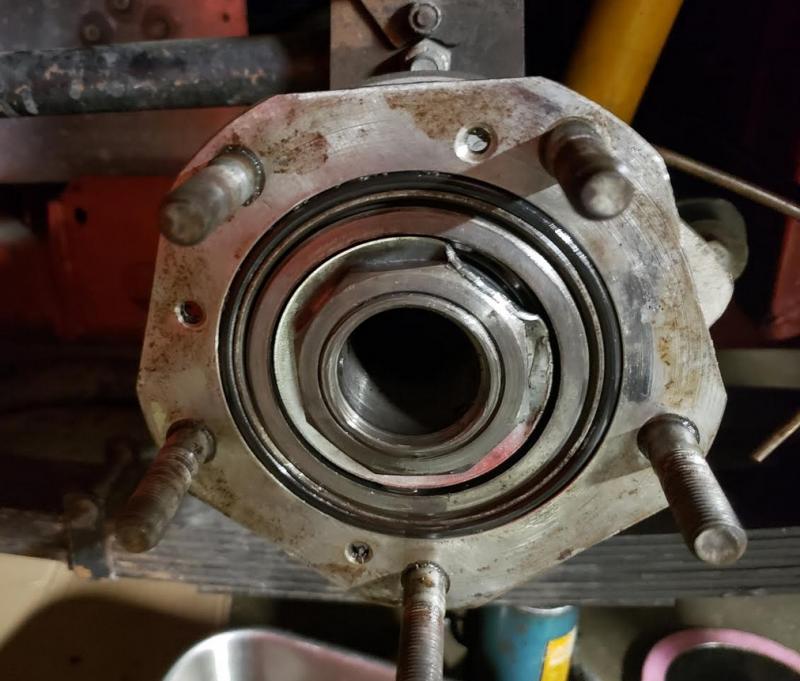

As a followup, I disassembled my other rear hub, found the bearing to have spun, installed new bearing with Loctite Bearing Mount Stick, measured clearance at .004" (same as other wheel). Installed a .003" paper gasket with a little Hylomar. Hopefully Bob's my uncle. If the combination of clamping and Loctite gives out, next time will knurl.

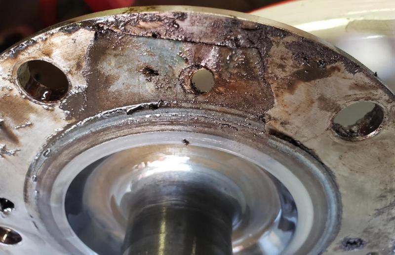

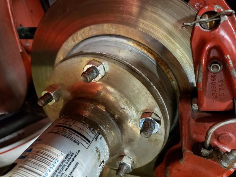

4 years later, my left rear wheel started leaking out the flange. The spring-type lug nuts were all almost loose so maybe that contributed to the problem. Will be replacing those with loctited Dorman nuts.
The bearing and seal are OK.
The .003" copier paper gasket is completely gone except for a couple of small pieces. Bad idea. No evidence of Hylomar either.

Hey Steve, have you found a different lug nut for the adapters? i recall you mentioning dorman lugs. GONZO
Gonzo,
I ditched the copier paper gasket and used only the Gear Oil RTV in combo with Dorman 7/16-20 lug nuts with Permatex Orange Thread Locker.
I checked my other side and the standard spring nuts were tight with no leaking, so left them as is for now.

I checked how much the bearing spacer protruded beyond the hub face on my left hub and found it didn't. I made an additional spacer out of 0.003" shim stock that I installed between the outer race and bottom of the hub, giving me the protrusion required. I then used the Gear Oil RTV. So far, so good.
