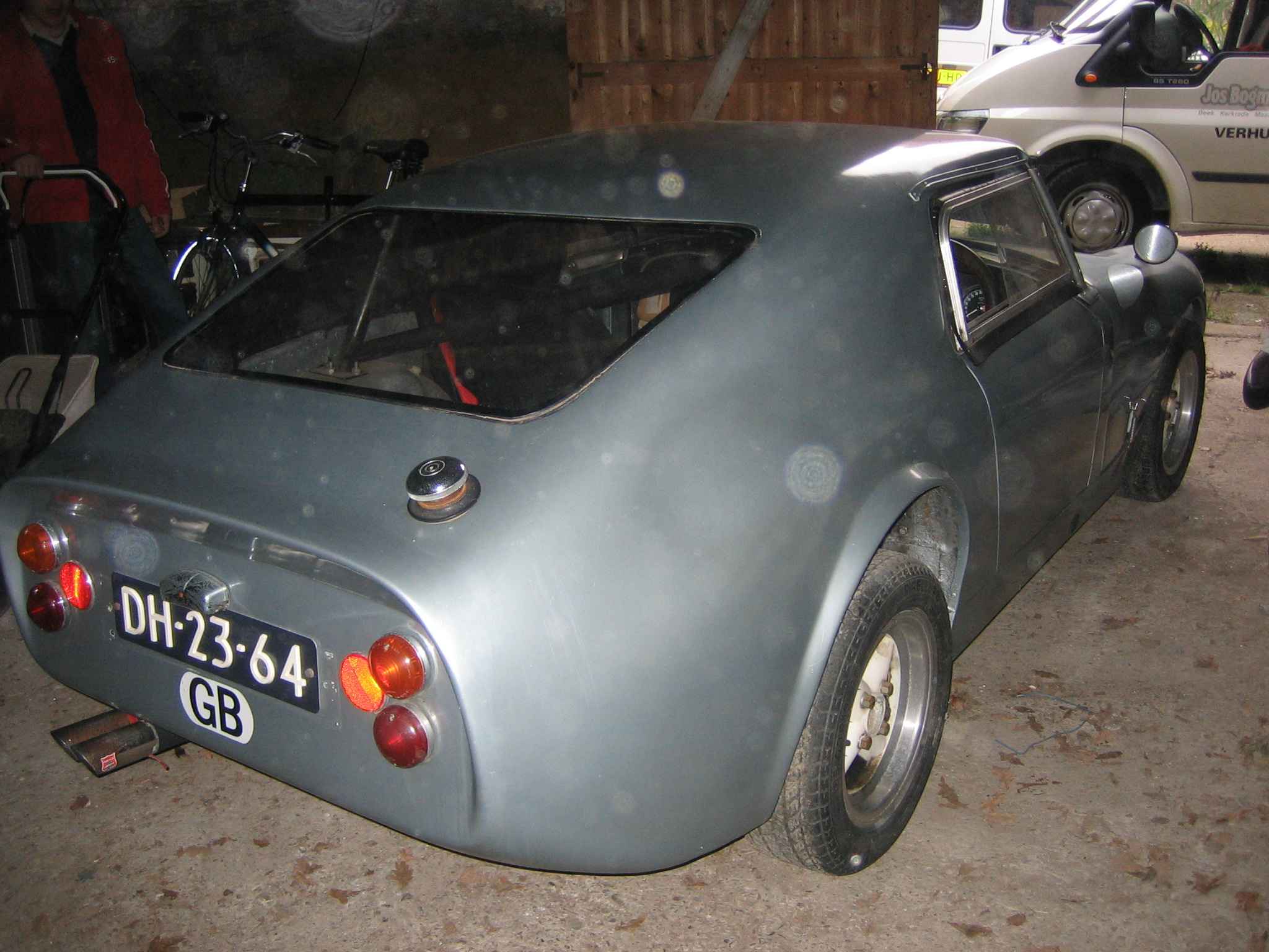

Dear all!
Who can help me in finding information about this Sprite coupe, Lenham? At this moment the car belongs to my family and is waiting for more information about her history. In general the car is in quite good shape although it did not run over the last 8 years, but with some work to do it will drive again shortly.
The history as known at this moment is as follows:
The car was registered in the UK in 1959, last known licence plate is 5080KC.
The car is now registered in the Netherlands, since 21st of August 1992, licence plate DH-23-64.
Chassis s/n: AN515232
Engine s/n: 12CE-D -H 6636
RHD
Who can answer the following questions:
- What kind of body is it?
- What manufacturer? Is there a kind of type plate somewhere on the body?
- It looks like that the body has been build just after the production of the “chassis”. How can I check this on the car?
- Are there any other cars known with the same body? If yes, does anyone have pictures available?
- Are there any technical items I can check? The suspension on the rear axle is for example different.
I am very interested to get in contact with people who can help me in finding the history of this car!
For questions do not hesitate to contact me. Plenty of pictures are available!
Alex

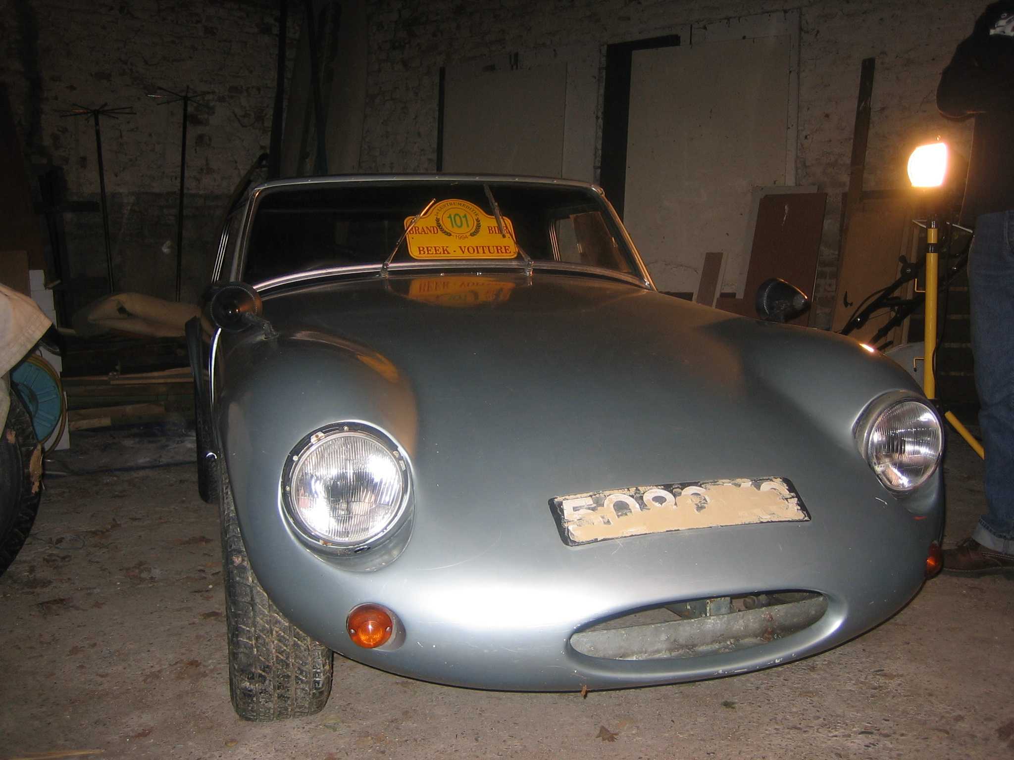

Another picture.

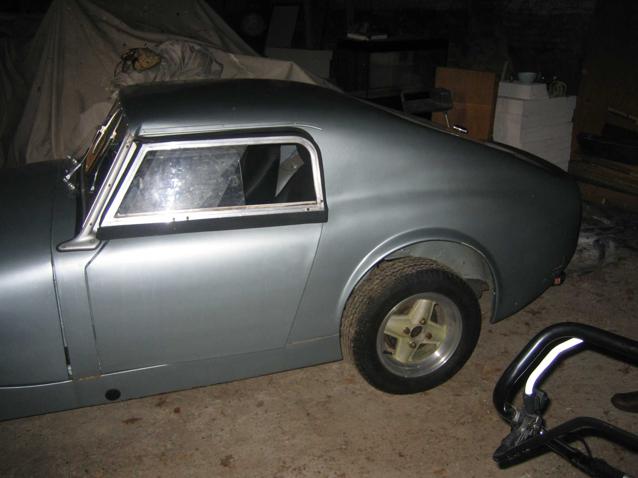

And a 3rd picture!

I don't thinks it's a Lenham - see here https://www.wwah.org/wa_01car7.htm it may be a Sebring, try www.sebringsprite.com also try Paul Woolmer of the UK AH Club, he's a bit of an expert os sprite specials https://www.austin-healey-club.com/Pages/AH50-woolmer-series.htm
Try tracing the registration - or even try tracing from the original sprite heritage certificate?
Or try contacting Julian Booty or Peter Rix at Lenham directly
https://www.lenhamsportscars.com/postman.php and see if they have any records of your car
Here's a pic of the later body style (rear quarter window)
https://www.gerardsgarage.com/GarageContent/UniqueSprites/lenham/Lenham.htm
The Lenham Coupe body came in 2 derivatives - an early one, and a late one.
The 'early' one didn't have rear side quarter windows - the later ones did.
The earlier ones were much better looking than the later ones.
It looked like an E-type from the front - and a bit like a Datsun Z car (Kamm tail) from the rear. You could just put the Fibreglass Lenham Coupe body on your Sprite in the 1960's.
