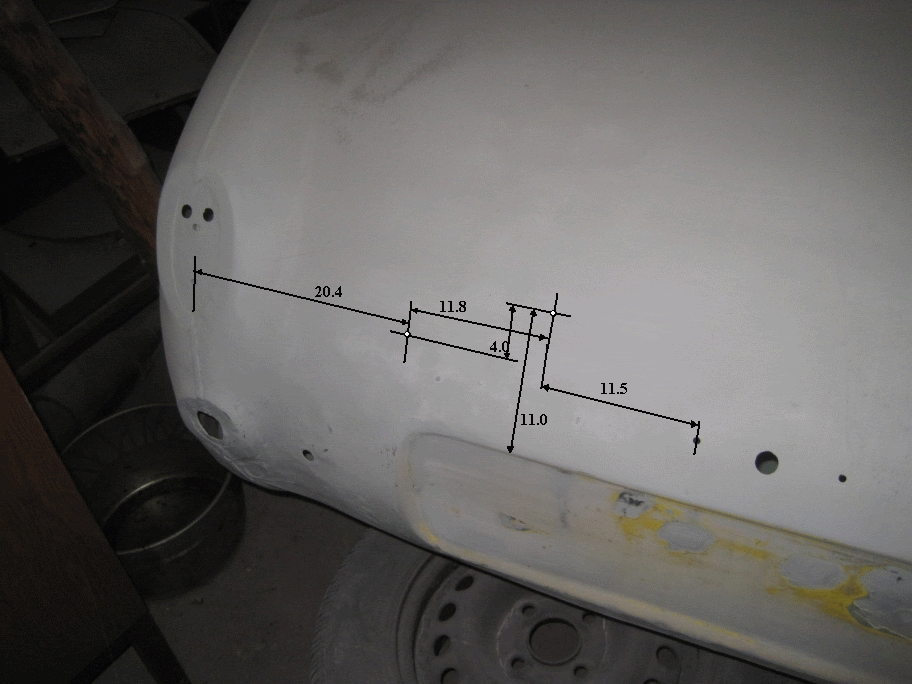

Does anybody have measurements to place the Sprite arrow on the rear deck? I know it's on the driver's side, across from the gas cap, but how far up, etc?

When I got inside the boot, I remembered that there was some slide hammer work done way back when, and that there are additional holes. I picked the two holes that had water mark stains as the original mounting holes(see photo), and hand drilled the bondo out. After backing out of the boot(Whew), :crazyeyes: I took some photos and measurements (See photo)

Maybe you weren't looking quite far enough down the boot cover. They were much lower than I remembered. They have to be there. Use my measurement as a guide to finding them.

For future reference, Donn's photo can be found in my Tech section. Donn graciously allowed me to publish it.
Larry - DON'T use a power drill!!! :nonod: Knock the stalactites down first, if there are any, then use a smaller bit than the hole size as Jack suggested. Hold the bit between your fingers and come up softly from the inside. Try to keep the bit centered as much as possible. Once the small holes are through, come down from the outside with the proper size bit using the same technique. you should be able to do it without chipping the new paint. The Bondo is still very soft, even, as in my case, after 35 years. Go slowly and good luck. :thumbsup:
