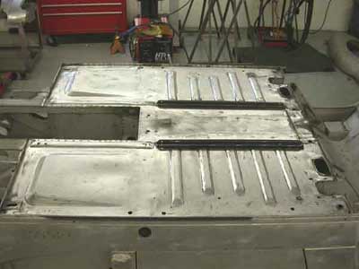

After doing some poking around on the web, it looks like the major difference in the early and late floor pan is the cut out for the 1/4 elptical springs. Does anyone know if there are other differences?
Here are two photos... one lifted from the Classic Motorsports Midget, the other from brother Ray! (thanks Ray!lol)
Here's the CM midget. This one also looks like a full floor pan... one not cut in 1/2.

Here's Ray's floor pan from an early spridget.

In addition to the cutout for the spring the later pans have oval wholes towards the rear that land between the front and back of the bulkhead panel. You can see them in the picture of the car underside you posted. I've use early pans on later cars but not the other way around.
hmmm, I wonder what the oval holes are for.

I've always assumed that those holes are for clean out and inspection of the hangers.
