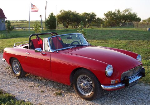

My last one pictured below was base coat clear coat and went on pretty easy. Like enamel, you need the proper temp reducer and it takes a little longer to flash off properly. I either went on too heavy with mine or didn't allow enough time to flash as there were a few tiny craters in the clear. It came out pretty good otherwise. Base coat clear coat is definitely better looking than enamel but I advised enamel above for the first attempt because it is less steps and a little easier.
I would not advise anyone to paint one in their basement. Like was already said, the fumes are highly toxic and very explosive. I built a room inside the garage out of 2 x 4's and covered it with clear plastic. I put several a/c filters in one end and used an old condensor fan from an old outside unit of a central A/C in the other end. The end with the filters was towards the back of the garage and the fan was in front blowing out the garage door. I made a removable door big enough to get the car in and out and a smaller door for me. That worked pretty good. I sprayed with the garage open and was still a little worried that the fan motor might spark. But this kept things in the garage from getting paint on them. The spray booths have special fan motors that won't spark or are shielded.
I used RM paint and did 2 coats primer/filler, 2 coats of color, and 2 coats of clear. I talked to a local pro after I sprayed mine and he advised to let each coat flash off 30 minutes to an hour. I only went 15 like I did with enamel.
You are right about the color drying flat. It is dull as can be. I didn't know this and thought there was something wrong but tried some on a gallon can and saw it was fine
after the clear was put on.

I painted mine this past spring with polyeurathane basecoat/clearcoat. I put on 3 coats base and 4 clear. Painting was the easy part! Did that in one day. It's the prep and the final sanding that make the finish! When I finished painting, it was better than a rattle can but still had some runs, overspray etc. The next steps fixed those problems and really shined it up. 1st after painting, wetsand by hand with a foam block with 1000 grit, then 1500 grit then 2000 grit. Entire car will then be flat. Then get a pro high speed polisher and go over with rubbing compound at 1000rpm. Then polishing compound at 3000rpm. Finally then handglaze. I've gotten a ton of compliments on my car since. My dad works at an autosupply house and they have a paint division. The guys there were a great help but paint and supplies were still almost $500 even with his discount.

Thanks sledge, I haven't done anything to mine but spray it on. Those additional steps might fix mine right up. I have plenty of clear left, maybe I should go on with more coats after a dulling with a light sanding then go with those steps you suggested.
Yes, the poly paint is very expensive. I bought mine on line and it was shipped to my front door.
