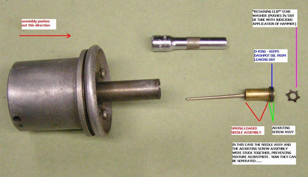

I'm rebuilding my Zenith-Stromberg CD150 carb this weekend. My carb rebuild was going along very nicely when I found that I couldn't pull the metering needle out of the piston. I tried to screw the adjustment screw out, but the hex hole stripped when I tried to turn it. (I think a little water got in under the damper oil and rusted things solid. Grrr....) To add insult to injury, some previous owner or sloppy mechanic pressed the metering needle too far into the piston, well inside the face of the piston, which explains why my car ran rich even with the needle set to be fully lean.
So, I figured I would just have to buy a new B1DL needle, adjusting screw, and piston, wait a few days for parts delivery, and then finish the job. Well, pistons are no longer available, it seems. Metering needles and adjusting screws are available everywhere, and they're not too spendy either.
So, I have to figure out a way to get this metering needle and adjusting screw out of this piston. Does anyone have any ideas?
