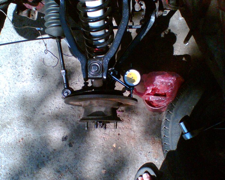

I attached a picture to show how to check with a dial indicator. The Disk moves with the hub. mount the indicator on the suspension (the a-arm are fine) and measure off of the disk. The advantage of using the indicator is that it is easy to be fooled by the felt crush seal when checking by hand since it the wheel will start resisting turning. However the bearings are still way to loose.
Note that you do NOT want free play! the bearings should be preloaded. Otherwise you will ruin them.

The screw solution sounds good I'll try it this weekend. There are holes in the caps. Yisrael, I don't see the attachment.
Opps I found the picture, and thought I attached it.
try 2
and try #3!
