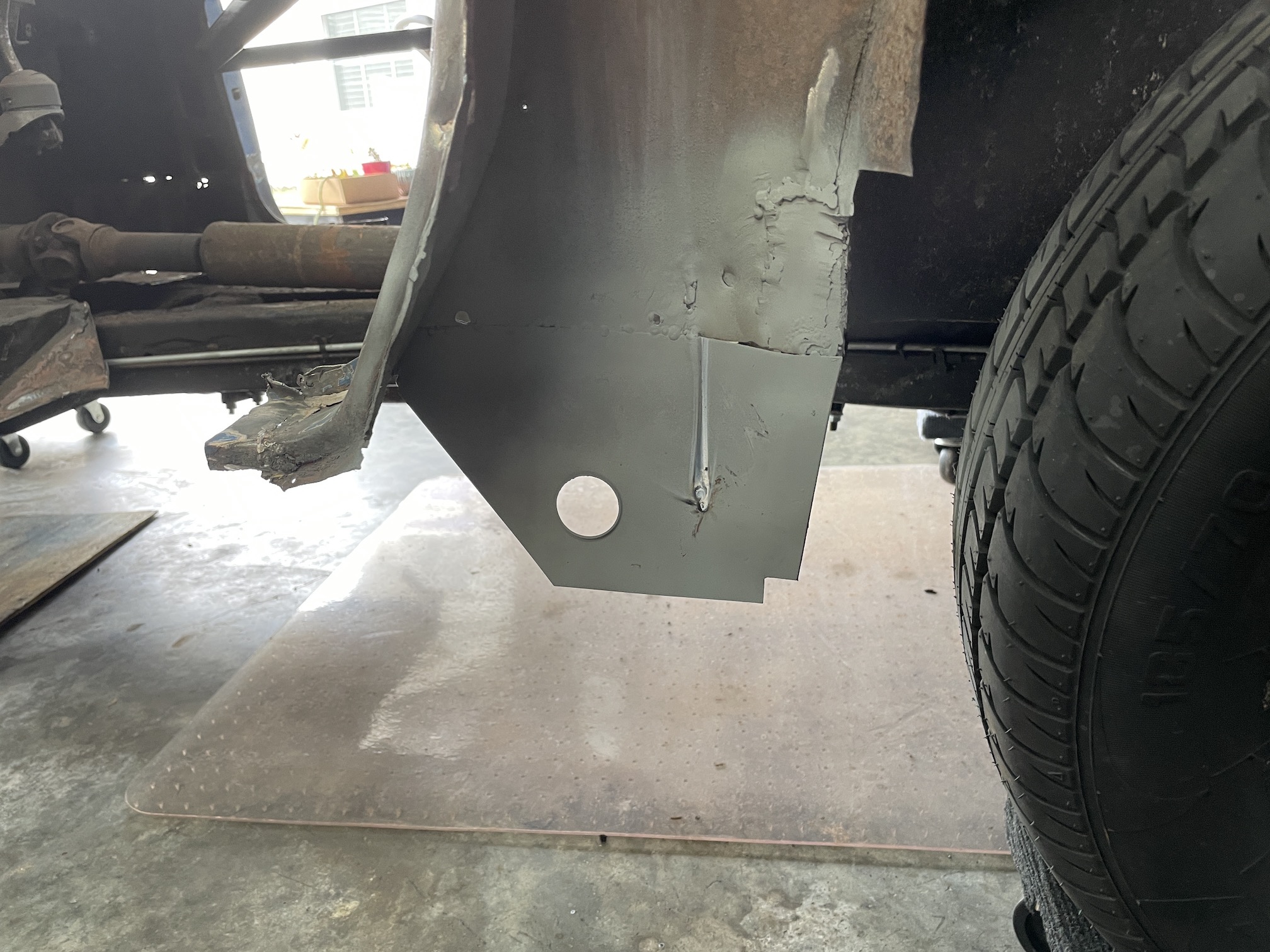

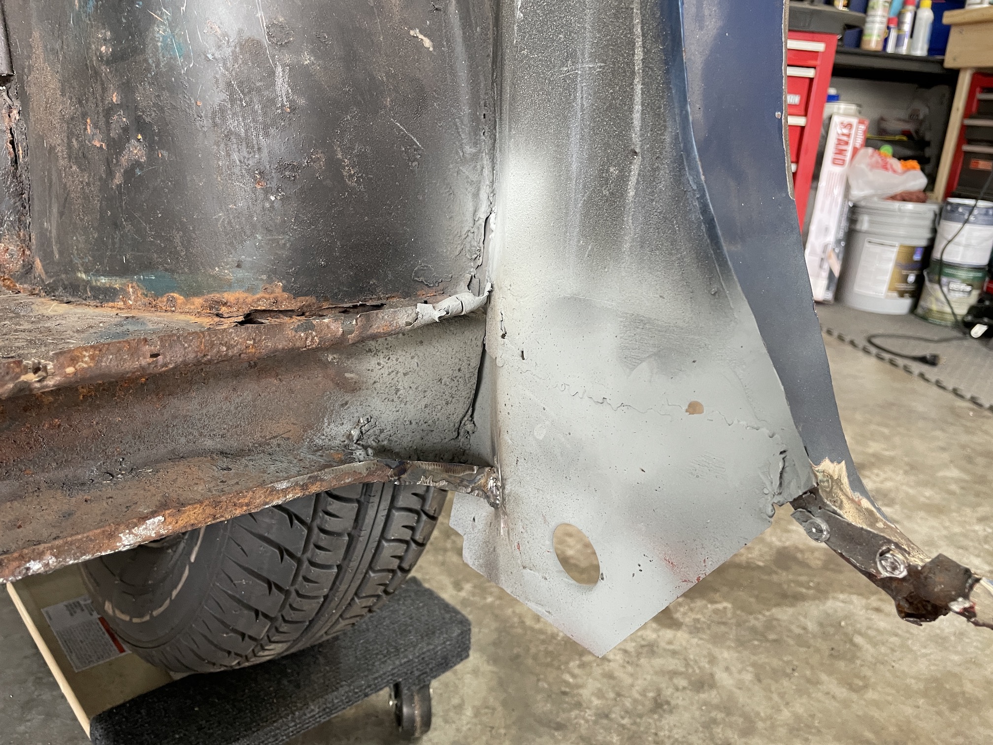

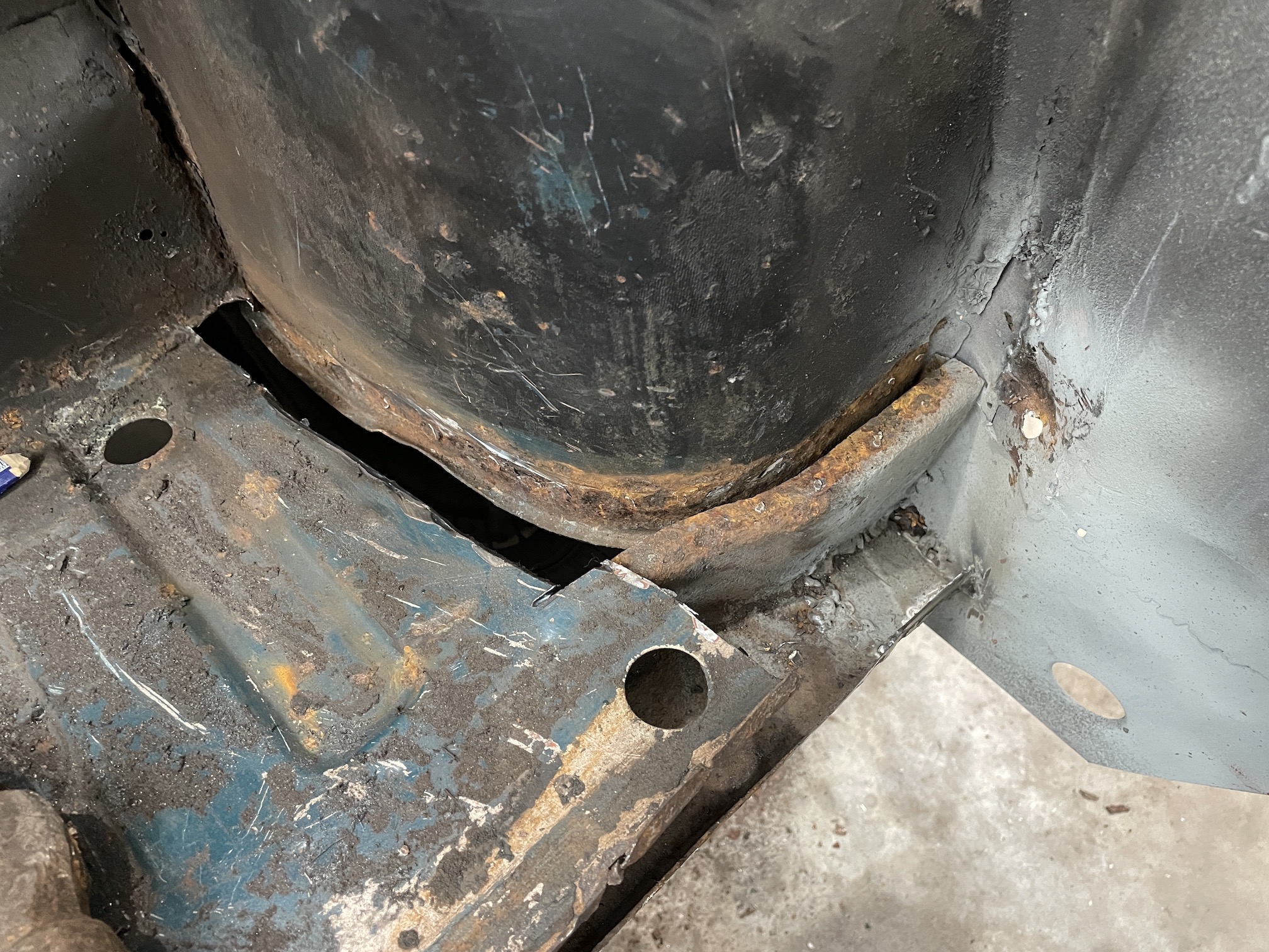

I have cleaned up the metal on the drivers side B post and finally got the cross member patched up as well.
Today I put it all together and got it mostly welded up. Still have some added grinding and sanding to do but the drivers side is almost done. Once I get it finished up I will have to move to the passenger side, remove the wing, and do the same work on the B post.
Once that is done, I’ll be working on putting the new heelboard on. Oh!! I forgot. I also need to patch up the small deck above the heelboard. It is rotten near the wheel arch.
About all I have for now. I’ll be uploading a video soon highlighting the work. It’s slow, and it’s ugly but I’m brand new to all this, so any forward progress makes me happy.

Thanks for the support. 118º? No thank you! You must be out west somewhere lol. Here are some pictures that I took recently. It isn't pretty, and I still have some flap disc work to do, but its getting there. Also posted a new video today. I'll share a link.
