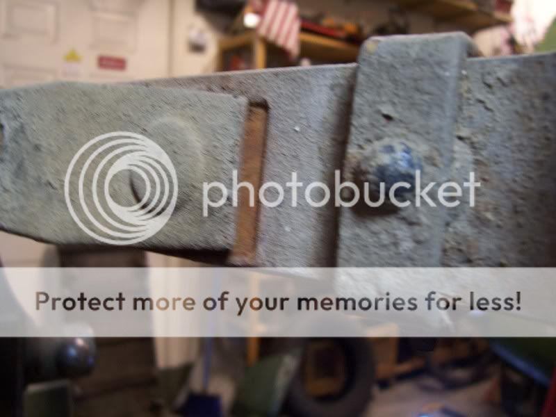

I took a better look at the first spring, check out how worn out this thing is:
The rusty(clean) mark is actually worn in about 1/16". The other spring wasn't much better. I replace 6 of the 8 buttons with carriage bolts, with the rounded head facing down. 4 of them replace the rivets holding the alignment brackets and 2 I cut the threaded parts off. I know it's pretty half-@$$ed but the bolts are pretty soft and cheap. I just wanted to see what it would get me:

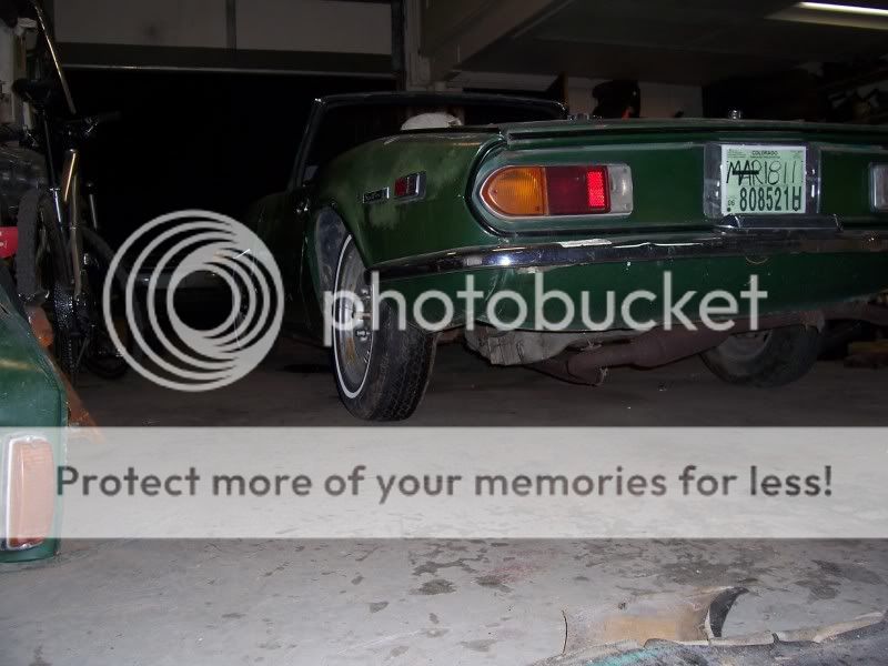

It's a marked improvement if I do say so myself. (note the exhaust is no longer hanging down)
It still has a lean to the drivers corner though. Time for a new spring and trip to my alignment guy. On a good note, the car does have all new shocks!
