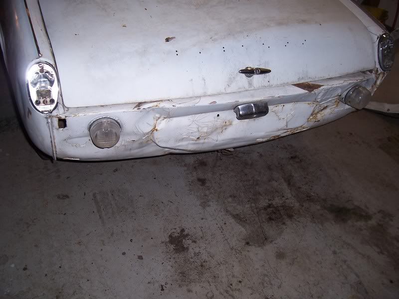

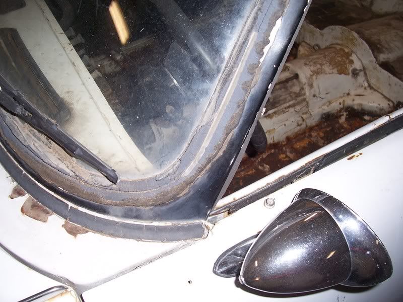

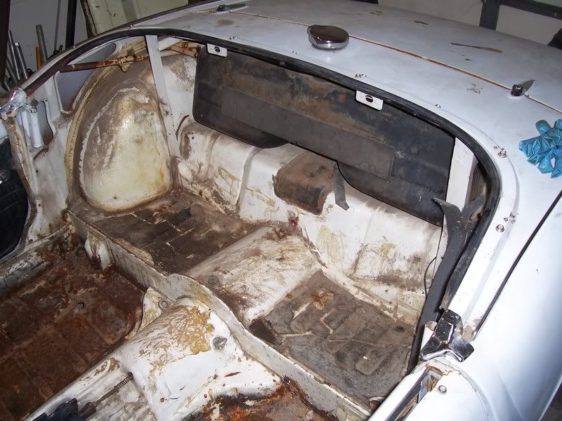

You guys wanted a few more pictures of the $202.50 ebay Spitfire, well here are a few!
Now tell me what's wrong with the pictures! What parts are correct or not! The seller didn't have any pictures of the rear of the car in the auction, wonder why? Either way, the car was cheap and is a good candidate for restoration. I think it's a far cry better than what I started with for the JPS build.
It seems to be missing an engine :jester:

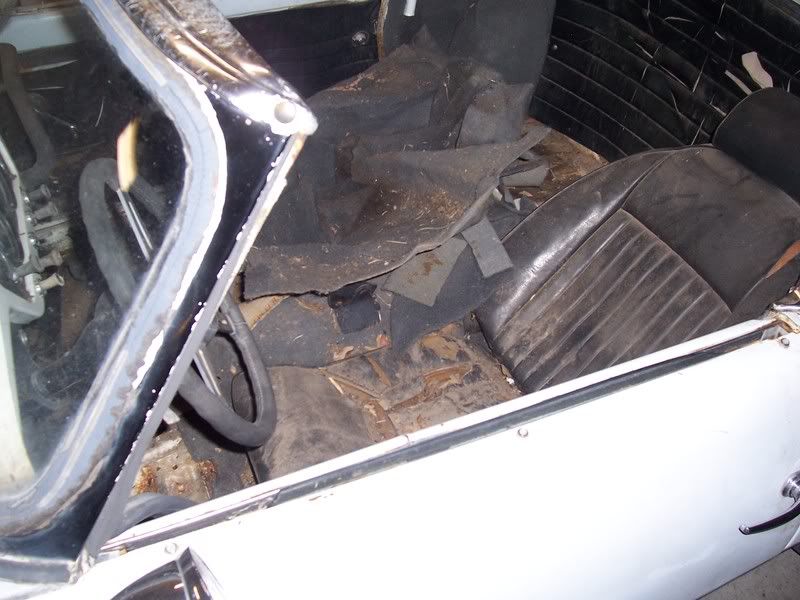

Seriously, it seems to be in fairly good condition. That seat with a headrest clearly isn't correct but for the most part it looks like the problem here is more missing bits than "wrong" bits.

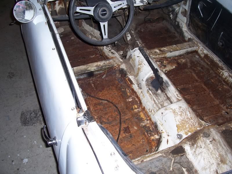

The steering wheel seems wonky to me. I thought they didn't go with the chrome three spoke till late in the mkiv series, right before they went with the 1500 horn on the turn signal stalk thing.

I think the steering wheel isn't either. Later model interior swap?

That's one of the things, It had a hodgepodge interior of MKI and MKIV parts and lovely do-it yourself grey carpet. The motor isn't and issue, I'm reassembling the head as we speak! There's more...

I visited this car in person, and it will make a good restoration project. How about those big white lights in the back? I don't remember anything quite that large on the back of my MKl.

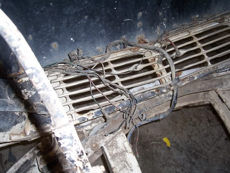

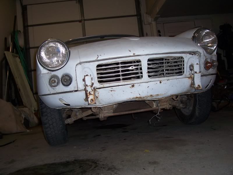

The car I see in the pictures is a survivor, and it deserves yet one more chance! Other than what's been mentioned, I see likely a Mk2 bonnet and windscreen surround. The grille is definitely Mk2, and both bonnet and windscreen surround appear to have been Royal Blue originally; that color wasn't used on the Spitfire 4. I'm guessing the front lamps from the original car were reused, since Mk2's in the US had larger plastic-lens flasher lamps on the front outboard position (as did late Spitfire 4 models).
In back, well, you're on your own there, pretty much free to do whatever you want and need. Those white lamps are nothing Triumph and probably nothing Lucas. Although it really doesn't matter, the license plate lamp is correct, but it should be on a body-color plinth. This one appears to mount directly to the valence, as was the case on later Mk3 models. Those plinths were rather fragile, so I'm not surprised it didn't survive whatever caused all the other, uh, rearrangement on that valence.

First thing i'd to is spend some quality time with your baby &
disconnect or remove all items (that can be removed)& strip it to the absolute shell.Send it to a company experienced in chemically dipping body shells.,Look at it carefully to see how much effort it will take to bring the body BACK TO LIFE.Then spray the ENTIRE SHELL with Rust-o-leum PRIMER.That will give you a base line to start dreaming.Anything short of that will be nothing but procrastination.Its the same process that you see professionals do on "OVERHAULIN"..ON TV...

Nah, I'm planning on glassing the holes in the floor and a bit of POR15 to the floors. Slamming the 1500 in it and drivin' for the season. Nobody mentioned the mirror! MKIV big time!?!? Andy, the "royal blue" looks straight up black. I can find it on the frame, bonnet, doors, and boot. But there is still white paint here and there, sorta over under. The car is obviously an abortion, but I like it! It deserves the 1500! :jester: I pretty much have the motor done as of today. I did discovered I don't have a water pump housing or pump. I do have 7 carbs, 3 distributors, 2 fuel pumps, 3 speedos and a truckload of misc crap... Anyone have a water pump plus housing? I have trades!
Well, they were using bullet mirrors as early as 1969 if not before, so they don't bother me. Actually, door mirrors probably were not required in most states when this car was built!
Oh, well, always hard to judge via pictures over the Internet. Sure looked blue to me. :wink: Anyway, it's still at least a Mk2 grille!

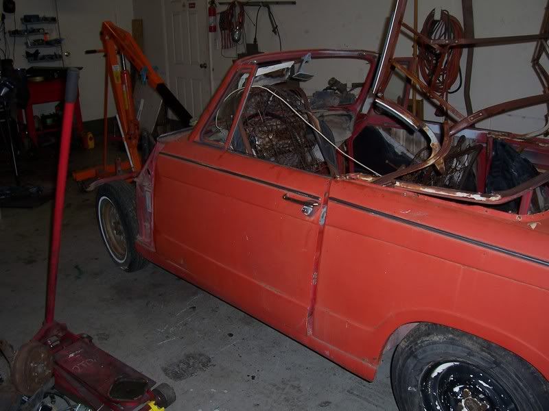

Another smart alek comment and the Herald get's it! :jester:
Just kidding, kinda! Look at all of the rust free metal Andy! This car is cleaner than the PE one! It's gonna be even more bitchin' after I tub it and street rod it. I know it's a long drive and all, but you need to rescue it! :devilgrin:
