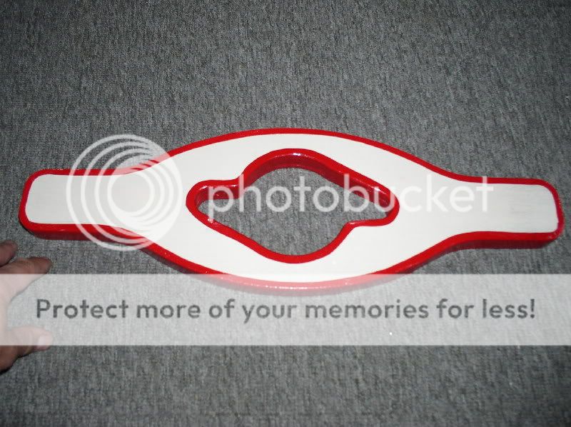

But I thought I'd share with you a solution I came up with to my existing spinner wrench.
Because of its excessive use and abuse, areas of my wrench have developed grime, nicks and splinters.
So, after cleaning it up and easing the edges as much as possible, I have decided to spray enamel the wrench based on the same color theme as my Healey (or close as possible) and of my own design.
I am still experimenting with patterns and other colors (ie: applying a third color, 'black' to compliment my black interior).
And for whatever it's worth, I purposely chose the darker (red) color on those areas subjected to the most contact or abuse while leaving the remaining field white (in my case).
I've already used this finished wrench once and developed nicks or chips on it, as I suspected. But doing touch up work after by applying the spray enamel directly onto a Q-tip or brush has proven an easy fix. And cleaning enamel has also proven much easier than say, trying to remove the grime from the natural wood.
I would of preferred to have kept the original wood finish.
Whatever pattern or colors I end up with, I'd like to think of this as a nice compromise.
Criticism appreciated.

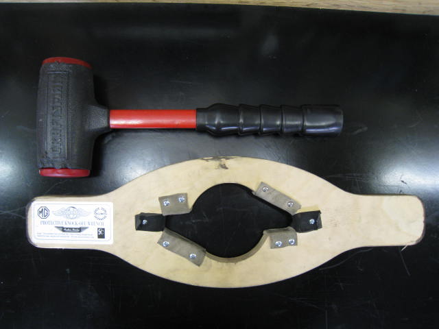

I use a "rubber" coated dead blow mallet. It works just fine unless it's cold (then the mallet coating can fracture). So far, no marks on the knock-offs.

I've found that the wood will start to splinter where it meets the metal ears of the knock-on. To rememedy that, I placed leather in those areas. I also use a dead blow hammer which doesn't damage the wood as a lead hammer does.

Two (2) hammer method here: rawhide hammer held against the spinner and whack the opposite side (also rawhide) with a heavy lead or copper hammer.
I get the wheels as tight as I want them, and the spinners still look like new.
I bought the wood wrench and immediately made a copy which is the one I now use. When it wears out, I'll make another copy from the original.
Be sure to jack up the car to take the weight off the tire first, Then tighten the knock off enough to seat the hub all the way, lower the jack and beat the @#$%!#$^&* out of it with a big plastic dead blow hammer, Then follow up with a thin piece of wood and a lead malet. I would rather know the spinner is on tight driving at 80 mph then to worry about chrome smugges! About 4 weeks ago a big dodge ram passed my healey on the left at 80 mph, All of a sudden his left wheel fell off and shot out in oncoming traffic at about 120 mph like a bouncing rocket. You should have seen the sparks fly off his brake disk and front bumper!!!!! I passed his front wheel and tire about 1/4 mile down the road! Wow... Michael.
