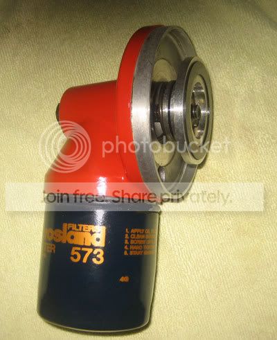

OK, here you go, from what I can see. You have my engine pictures to show what it looks like installed.
You should remove the old cannister and have that area clean and ready to go.
You need to get a Fram PH3600 or it's equivalent. If you can get NAPA Gold or Wix crossed over numbers, that's even better. For all intents and purposes, that is your starting point.
You do not have to drain the crankcase as this is all above it.
As I explained on the phone yesterday, when you hold the par tin your hands, you will see how it fits and what you have to remove to install it properly. Don't start tearing things apart that don't need to be removed and create more potential issues.
Get the part, study it, see what you MUST remove to fit it in place and install it. Keep it simple.

Spin on means exactly that. The entire assembly.
Ah Ha!!!!!!!!!!
There is indeed an auto mechanic's trick involved !!.
Compress the spring 100% with the bolt before trying
to place unit into the car. The bolt will stick out it's
full length.
Insert the bolt into the threaded hole and then rotate
the entire spin-on adapter until everything is snug and
centered inside the mounting ring.
Rotate into position to put on the filter can.
Unless you follow these instructions you will waste
hours of your time and ruin your nice powder coating surface.
