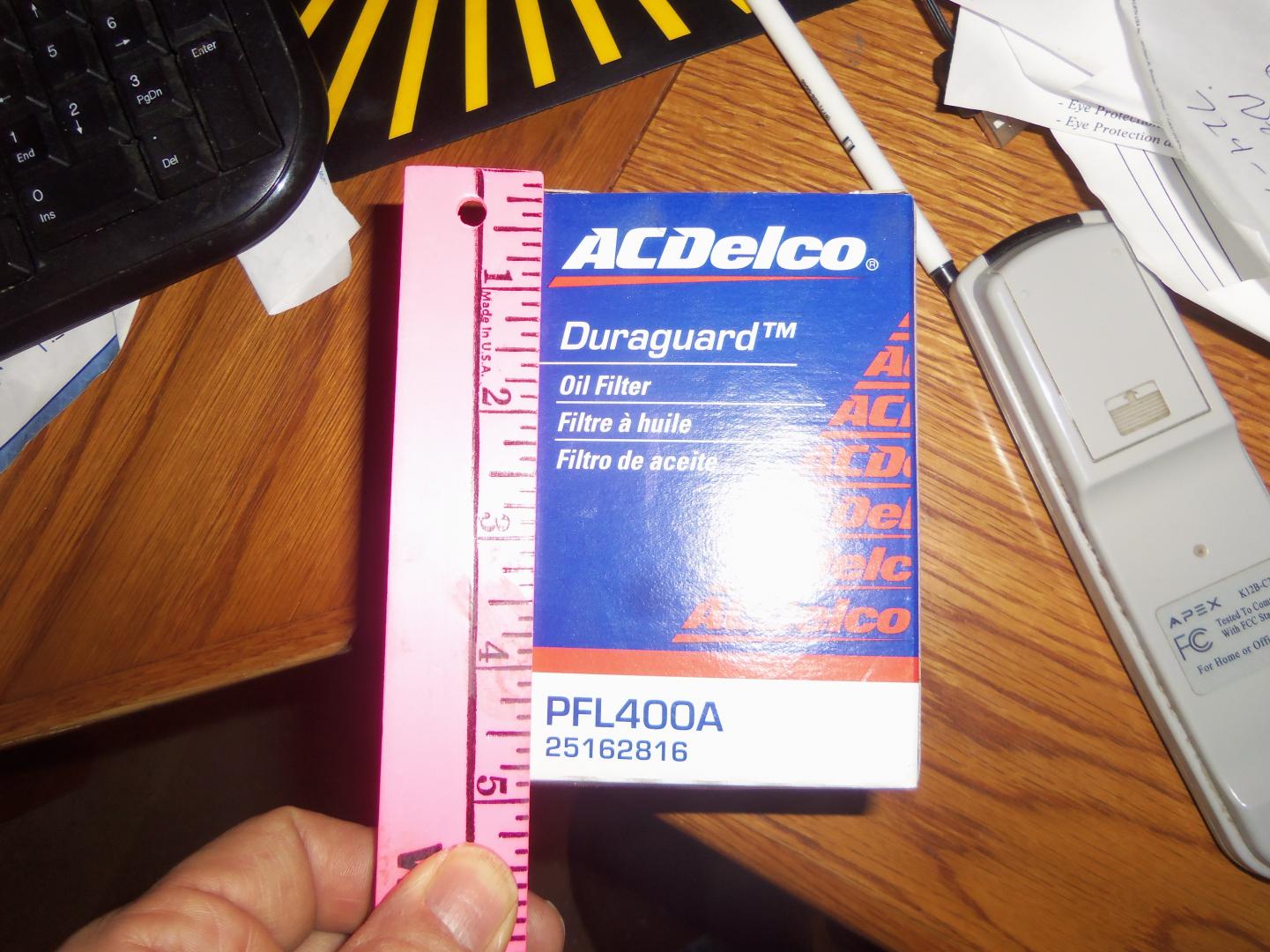

I had the same problems on my TR250. Just turned the adapter slightly and rerouted the lines and it was fine. However I had a problem with the oil filters that have the relief valve on the bottom. My oil pressure gauge was bouncing all over the place. Some told me that the valve in the filter was fighting he oil pressure valve in the engine block. Others said that that valve is only to not let the oil drain back into the block if the oil filter is mounted horizontally when the engine is turned off. So I set out to find a oil filter without the pressure valve. One of my GM dealers let me look and match up my Fram 3600 to one of theirs and low and behold my problem went away. The filter is pictured and I think it is a little shorter too.
