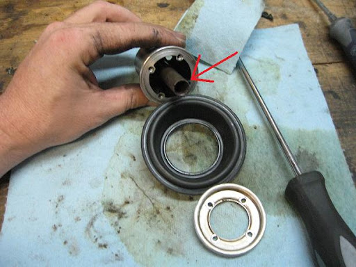

I was tearing down the Carburetor on mum's Spifire last night and I got to this point. Now, I'll admit I don't have the specs on this specific carburetor, but I've rebuilt plenty in the past.
You'll note the red arrow in the photo. This center shaft really looks like it should be removable. I attempted this, but didn't want to force/break the part.
Can someone confirm that this should be removable? If it doesn't come out I'm not certain how to remove the needle.
Thanks!
Jody
The center shaft isn't removable. There should be a set screw at the bottom that holds the needle in place. Remove the set screw and then you most likely have to use an allen wrench down the tube to unscrew the needle.
If you are referring to the part with the set screw that holds the needle it is removable. You have to force it out. It is retained by a externally fingered push washer. There is an o-ring around the piece that retains the damper oil in the shaft. If you search there are existing threads describing the process in more detail.
